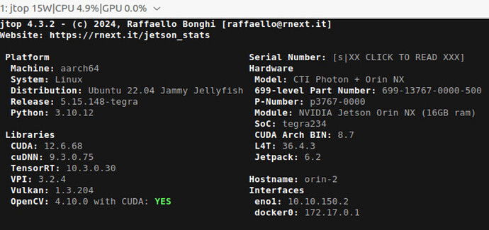

I have built OpenCV 4.10 on the Photon GNX002 board with the Orin NX 16 GB SoC.
This is part of a migration from JetPack 5.1.2 to JetPack 6.2 with the latest BSP with support for our cameras. We link our C++ software with our own build of OpenCV 4.4, using CUDA 11.4.315, the same version in JetPack 5.1.2.

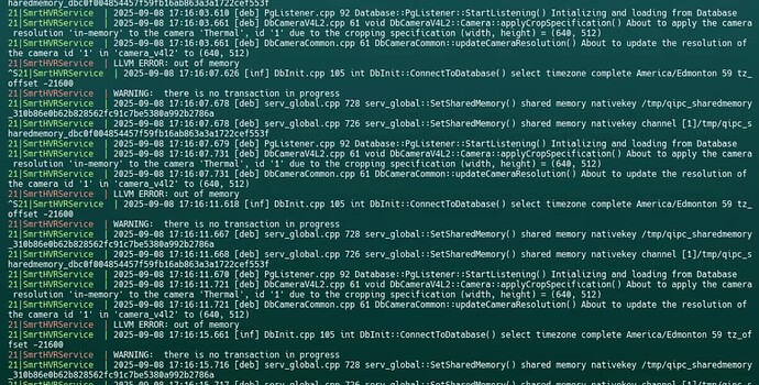

I have attached the script I used to build OpenCV. I recreated the engine files from the same onnx file that I used on JetPack 5.1.2. Then I ran a release build of our software, and I got the LLVM Error: Out of memory in our application logs, while the application crashed without any other errors.
When I run our C++ application from a DEBUG build, everything works as expected: I get cameras, analytics, etc. No errors in the logs.

Below is the system information after I ran the script attached.
build_opencv_JP62.sh.txt (6.0 KB)

However, when I ran our applications in RELEASE mode, the same error appeared in the logs. LLVM Error: out of memory.
The service restarts happen every 2 to 3 seconds. Before I continue digging deeper. Can you suggest a containerized solution for OpenCV with CUDA (thus with access to the GPU) such that one can keep the OpenCV 4.8 without CUDA support that the SDK installs. That way, one could build the C++ applications to dynamically link with OpenCV with or without the GPU acceleration and compare the application performance and resource utilization?

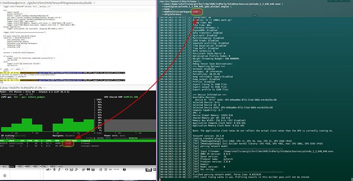

P.S.: I also tried using the trtexectool to do the ONNX to engine Yolov8 conversion with the same OutOfMemory error. The command line is as follows. I also tried smaller and larger memory pool sizes without impact in the error.
/usr/src/tensorrt/bin/trtexec
–onnx=/home/intelliview/git/hvr7/SmrtHVR/3rdParty/YoloData/Sources/yolov8n_1_3_640_640.onnx
–saveEngine=yolov8n_1_3_640_640_jp62.engine
–fp16
–memPoolSize=workspace:512M
Are the GPU memory and the trtexec memPoolSizerequested related this way when I lowered it to 128MB? jtop reports much higher GPU memory, ~420 MB, and it is at around 520MB when it hits the error and stops.
The memory problems were likely due to fragmentation, although I am less certain of their origin; it did not matter how small I made the batch sizes.
I cleaned up the memory by doing a reboot. Then I stopped and uninstalled our C++ back-end programs. Rebooted the machine again. Updated the C++ code to generate YoloV8 engine files, rebuilt the C++ services with OpenCV 4.10 without opencv_world, and started testing.

I was hopeful and ran our application to find the same error I saw a couple of days ago:
LLVM ERROR: out of memory
The engine files load without errors. But within one second of program execution, the first error and service crash happen. Very little information is available as to where it is happening. I will enable core dumps. Even in debug, the program is crashing. The operating system sends the SIGABRT signal. This same code runs on JetPack 5.1.2.
