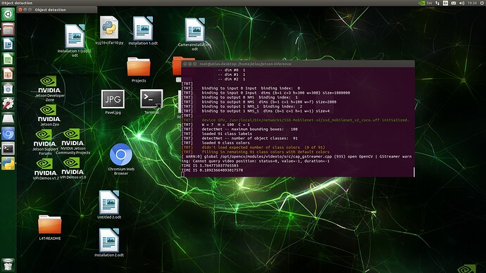

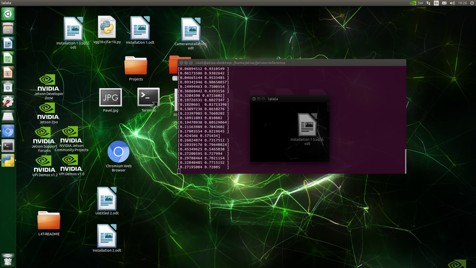

Camera is showing part of my desktop instead of the image sometimes

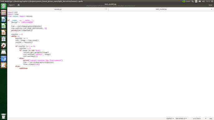

Hello.I tried to launch usb camera light detection resnet programm:
I got unusual bug:

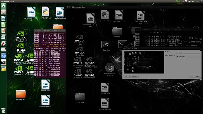

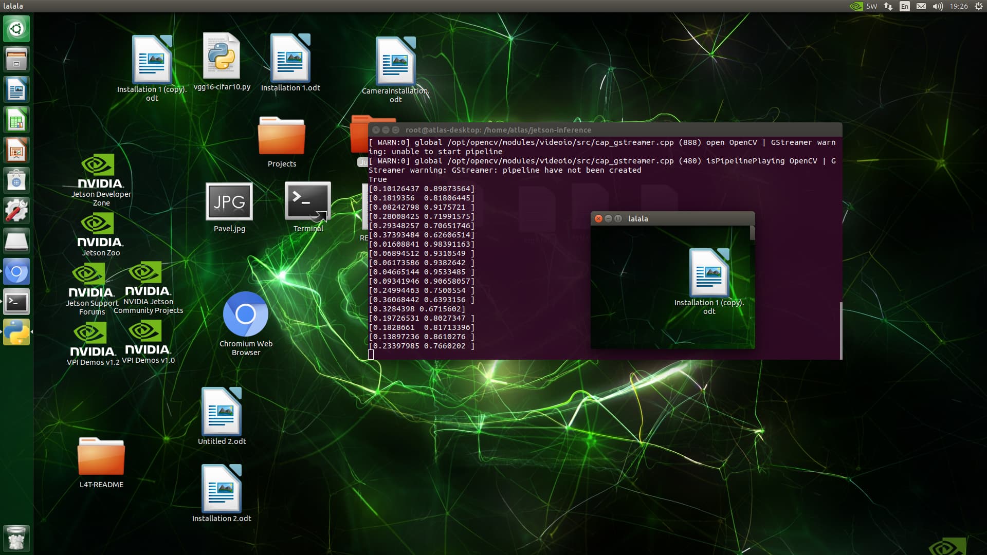

It seems, that the programm is working fine (because i dont have any errors), but camera is showing part of my desktop instead of the image from the camera.
Log is here:
log1.txt (3.1 KB)

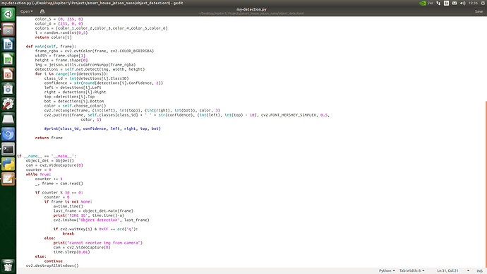

I also have the same problem with an object detection programm:
Log is here:
log1 (1).txt (8.6 KB)

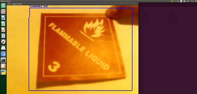

Usually it works like this:
Log:
log1 (2).txt (6.8 KB)
(It should always show image from a camera and detect object)
How can i solve the problems with light detection and object detection and make camera work correct for them ?

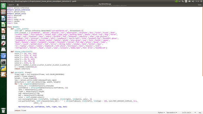

my-detection.txt (3.2 KB)
Download the code, change file format to py and put it in the folder.
  1. Rin the container with – volume by the commands:
cd /home/atlas/jetson-inference in the container
atlas@atlas-desktop:~/jetson-inference$ docker/run.sh -c name_of_the_container --volume /home/atlas/Desktop/folder:/home/atlas/jetson-inference
4.cd /home/atlas/jetson-inference in the container
5.python3 my-detection.py

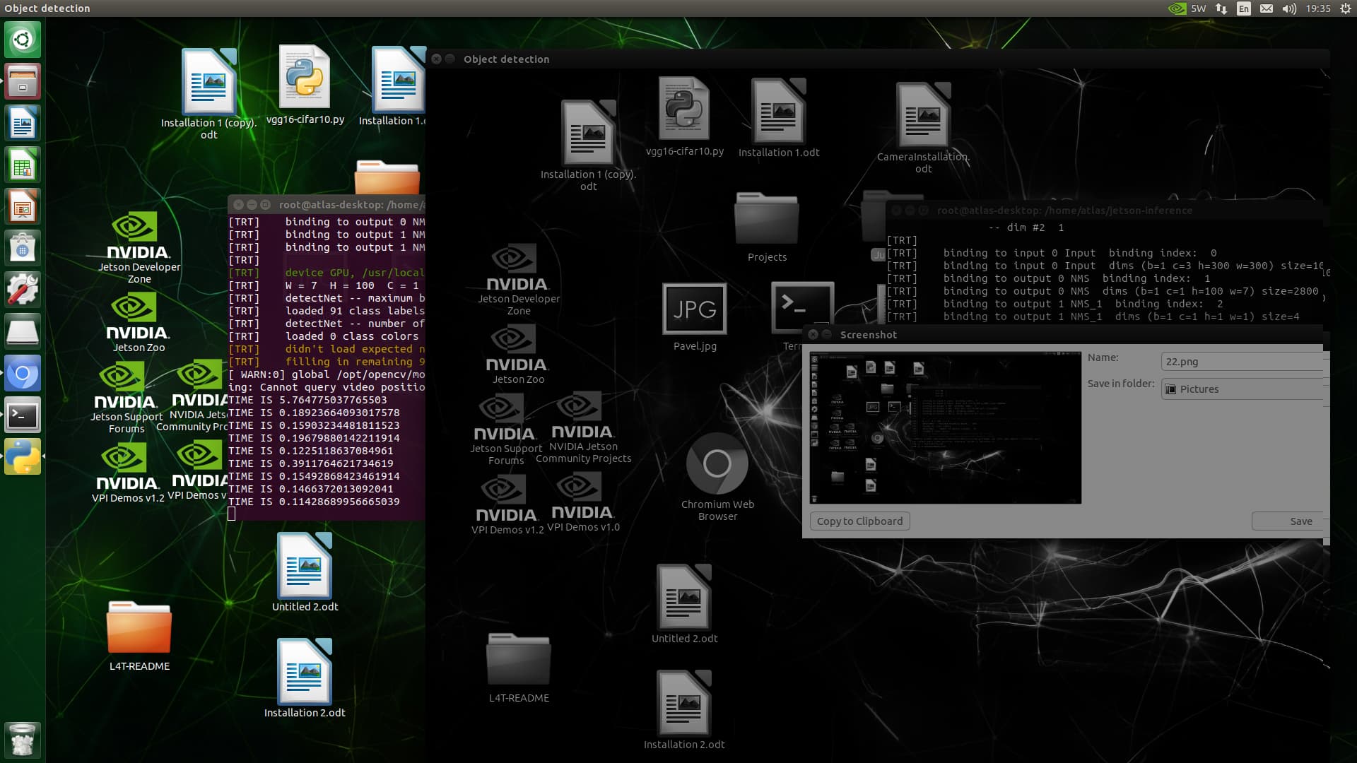

Hi A98,
We can run your sample code success on Jetson-Nano + r32.7.4.
Please test again with below command:
$ export DISPLAY=:0
$ xhost +
→ Launch container
$ cd /home/atlas/jetson-inference
$ export DISPLAY=:0
$ python3 my-detection.py
