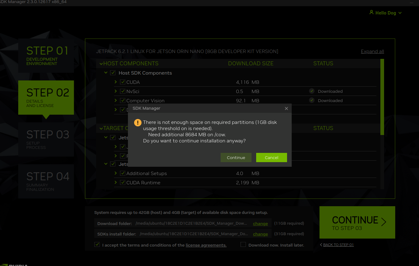

I just bought a NVIDIA Jetson Orin Nano Super Developer Kit. I installed this SSD:
Samsung 990 EVO Plus 1TB Samsung V NAND TLC NAND PCIe Gen 4 x4 and PCIe Gen 5 x2 NVMe M.2 Internal SSD
I am trying to flash Jetpack to the NVMe. I have SDK Manager running on Ubuntu 22.04.5 from a Live USB. The host computer has a 1TB HDD with 660GB free, and I selected that for jetpack file downloading.
When I start the install I get this error message (see picture). I don’t see /cow anywhere, and all my drives have adequate free space (except the live USB).
Does anyone have any ideas what is wrong, or what I might do to fix this?

Then I found a small SSD and installed Ubuntu 22 on my mini PC. Using the native Ubuntu 22 Desktop, I was finally able to flash it successfully.
I had tried several different approaches, including using a VM and a live USB, but all of them resulted in errors.
As suggest, please install native ubuntu (dual boot) to flash your device.

If sdk manager encounter some issue, we suggest use manual flash method.
Take JP 6.2.1 for example, please download Driver Package (BSP) and Sample Root Filesystem from Jetson Linux Release 36.4.4 | NVIDIA Developer .
And follow the Quick Start — NVIDIA Jetson Linux Developer Guide to flash your device.
