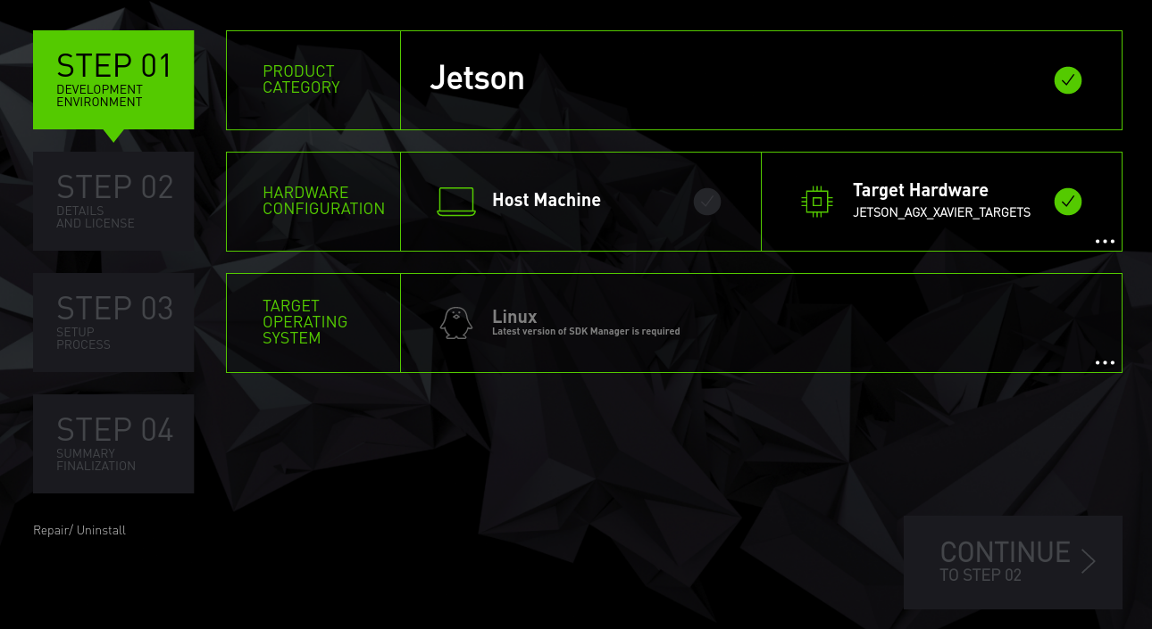

I got this problem when downgrading Jetpack. The GUI is disabled.
Hi @dusty_nv
Hi nha.tuan84,
Please download the latest version SDK Manager and try again.
If you want to use archived SDK versions which are not shown on the standard run, please run below command:
$ sdkmanager --archivedversions
