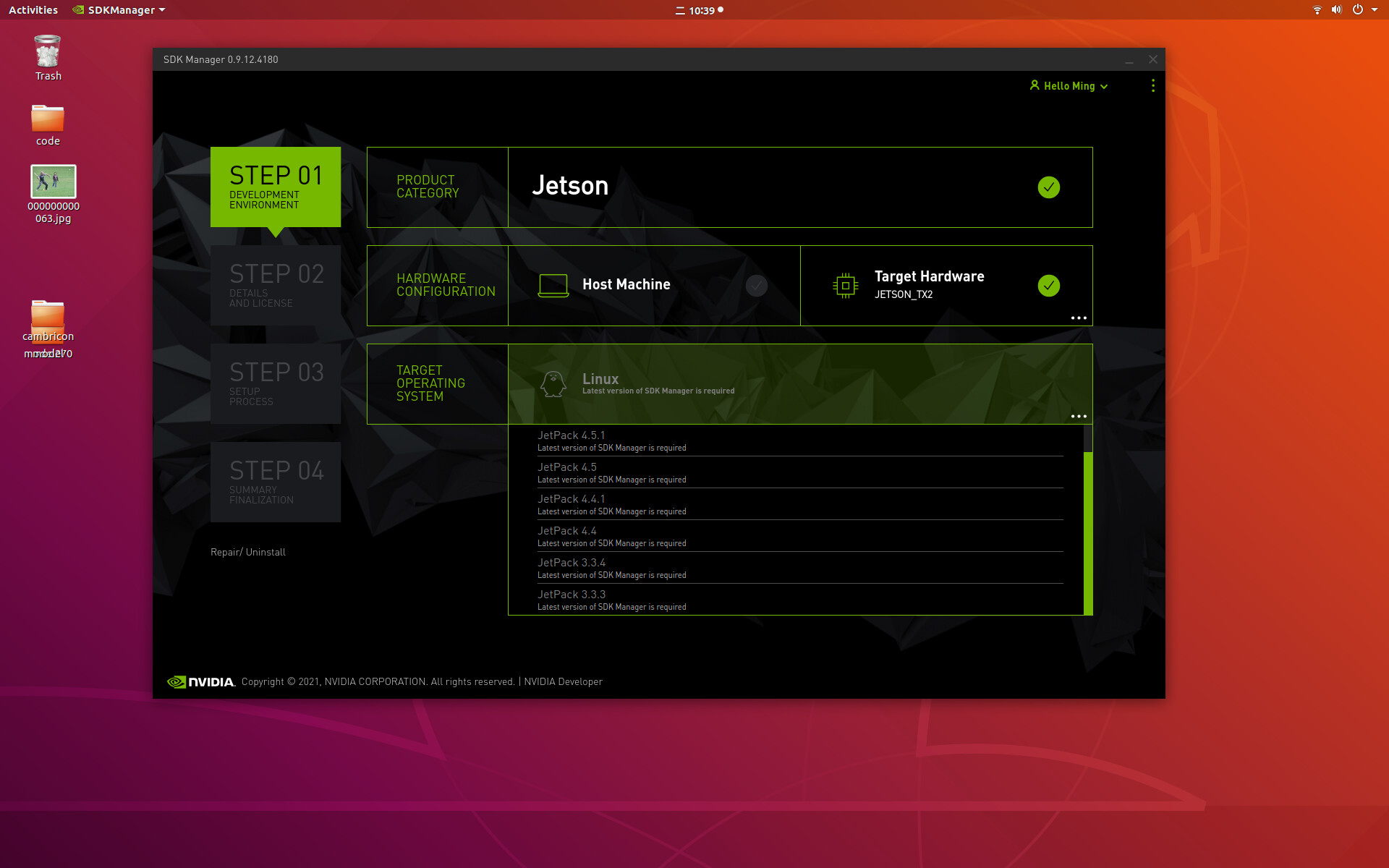

Can't find JetPack4.3 version in sdkmanager?
When flashing TX2, I found that JetPack4.3 version could not be found in sdkmanager?
This is the sdkmanager I downloaded from the official website of nVidia for JetPack4.3. There is no version of JetPack4.3 in it. Now I need to use the version of Jetpack4.3. Is there any way to solve it?
Hi 18916135705,
Please run below command to install old version JetPack:
$ sdkmanager --archivedversions
This error occurred.
Hi 18916135705,
Please update your SDK Manager to the latest version and run again.
SDKM v1.6 download link: NVIDIA SDK Manager | NVIDIA Developer
OK,thanks.
