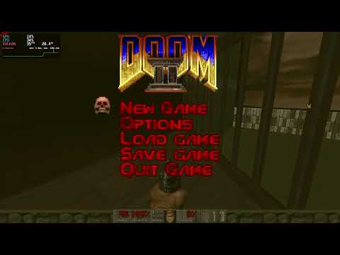

Hello there, when attempting to record your screen using OBS Studio 30.0.2 and Pipewire Desktop Capture results in an extremely choppy and laggy recording. The desktop it self is fine.
I attached a video recording a 3rd display using a capture card and pipewire to better visualize the issue.

Applications running in any form of fullscreen do not get updated in the capture at all:
My guess is it has something to do with Mutter redirecting fullscreen windows directly onto the screen instead of compositing them.
Yep, with the Gnome extention Disable unredirect fullscreen windows the capture does no longer skip fullscreen applications:

While generally I agree that it isnt as bad as I started reporting it I still feel like the recording still does not match the actual framerate of the capture. Like capturing on 60fps but the resulting video more looks like 30.
At least it is less fluent. Even if just moving windows. See video below (Set it to at least 720p@60 otherwise you wont see it) Also you may notice a delay of a few milliseconds between the capture card and the PipeWIre capture. Which makes me assume it may be linked to the same issue.
