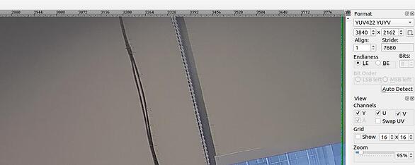

I’d like to add one more thing: I can currently get an image from the top layer, but there’s a green line on the far right. The trace log also contains the message “class:CORRECTABLE_ERR type:STREAM_VC phy:0 cil:0 st:0 vc:1 status:0x00000014.” Do you have any other debugging options?
hello MushroomHunter,
did you meant something like noise? could you please share a snapshot for reference.
video0_20250827_152605_981.yuv.zip (6.2 MB)
You can take a look at the yuv format picture.
sorry for late reply, may I know what’s the image resolution, image formats.
3842x2162,yuyv
I can view the image by settings width=3840.
this looks like garbage produced by sensor side,
please double check the sensor outputs, or, you may try to crop that as workarounds.
