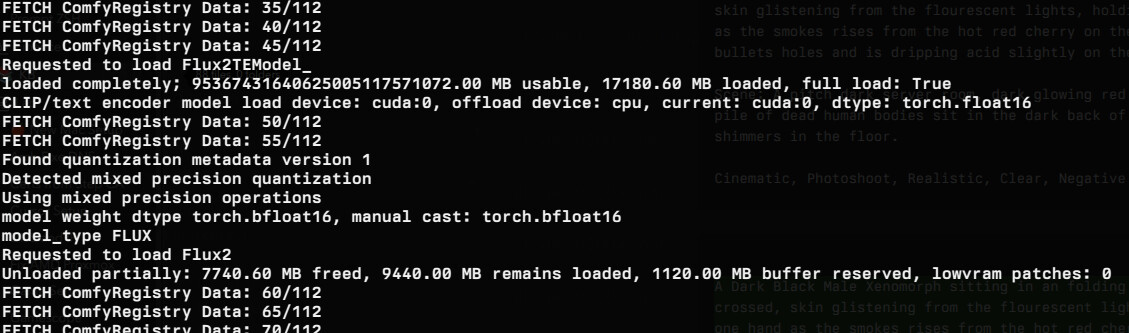

I’ve been running comfyui workloads on jetson Thor since last week, they reported 100% offload, but ran in GPU time quite well. Now since the latest update, they simply go OOM loading a small 30GB Flux2 FP8. Any ideas on how to resolve?
It’s saying I have a PB of VRAM now instead of 0, which breaks it.
For others this is a ComfyUI bug and I wrote a patch. https://github.com/comfyanonymous/ComfyUI/issues/11332

ComfyUI log, but it’s not really out of memory, it’s a calculation issue.
File "/home/matt/Local/ComfyUI/comfy/ops.py", line 631, in _apply
self.register_parameter(key, torch.nn.Parameter(fn(param), requires_grad=False))
File "/home/matt/Local/ComfyUI/.venv/lib/python3.12/site-packages/torch/nn/modules/module.py", line 1357, in convert
return t.to(
File "/home/matt/Local/ComfyUI/comfy/quant_ops.py", line 205, in __torch_dispatch__
return _GENERIC_UTILS[func](func, args, kwargs)
File "/home/matt/Local/ComfyUI/comfy/quant_ops.py", line 321, in generic_to_dtype_layout
return _handle_device_transfer(
File "/home/matt/Local/ComfyUI/comfy/quant_ops.py", line 272, in _handle_device_transfer
new_q_data = qt._qdata.to(device=target_device)
torch.OutOfMemoryError: Allocation on device
Got an OOM, unloading all loaded models.
