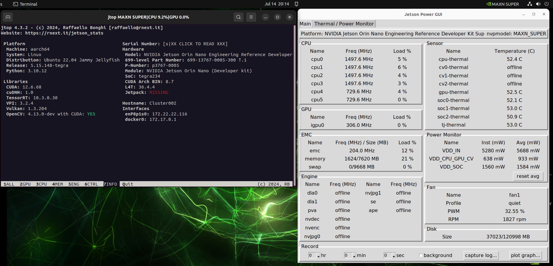

Solved OPENCV with CUDA support - DONE
Jetpack 36.4.4-gcid-41062509 - Done

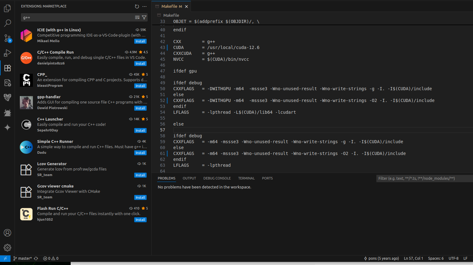

g++: error: unrecognized command-line option ‘-m64’
g++: error: unrecognized command-line option ‘-mssse3’
Works with an OLDER Version of g++
Migrating C++ Code from Hungry Power machine Ubuntu 18.04
Thus… SAME speed just with CPU’s.

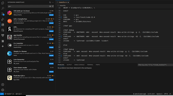

I have NOT used OPENCV with CUDA ! YET !
Strongly Recommended after Jetson SDK Manger adds missing libraries & dependencies. UBUNTU has Archived a few, useful for old budies UBUNTU 18.0
Any ideas to Compile

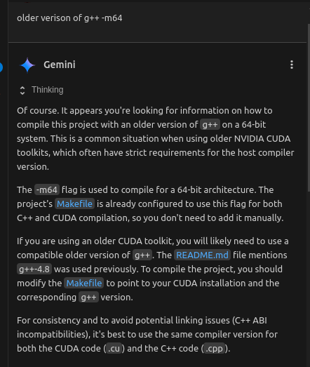

Of course. It appears you’re looking for information on how to compile this project with an older version of g++ on a 64-bit system. This is a common situation when using older NVIDIA CUDA toolkits, which often have strict requirements for the host compiler version.
What is SSSE3?
SSSE3 is a set of CPU instructions that perform SIMD (Single Instruction, Multiple Data) operations. This allows the CPU to perform a single operation on multiple pieces of data simultaneously, which can lead to significant performance improvements for tasks involving heavy computation, such as the large-number arithmetic required for elliptic curve cryptography in this project.
