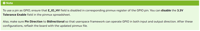

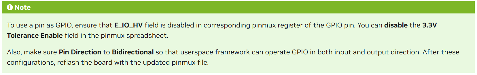

The most of pins are configured as GPIO Input by default, but you can configure them as Bi-directional in pinmux spreadsheet instead. We’ve also mentioned it in developer guide as following:
However, we have a known issue in both JP6.0(R36.3.0) and JP6.1(R36.4.0), which has been fixed in JP6.2(R36.4.3).
