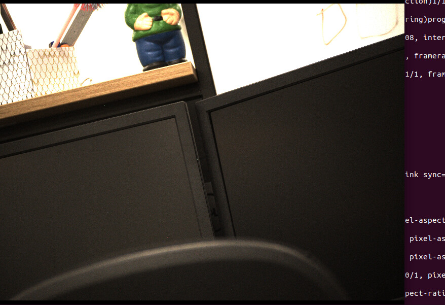

running suggested pipeline fails cause of high resolution so i scaled it down:>
gst-launch-1.0 -v filesrc location=frame_4112x3008_RGGB_0.bin blocksize=12368896 ! video/x-bayer, width=4112, height=3008, format=rggb, framerate=15/1 ! bayer2rgb ! videoconvert ! videoscale method=0 n-threads=4 ! video/x-raw,height=2160,width=2160 ! xvimagesink
And i received a image shown.

when i trying to convert this VYUY image i get image with aliasing, maybe it’s stride problem? but it not made sense cause gstreamer know VYUY format…
3 files are attached
  1. test.vyuy vyuy file grubbed using video4linux
    test.vyuy (23.6 MB)
    created by:
gst-launch-1.0 -e filesrc location=test.vyuy ! videoparse format=vyuy width=4112 height=3008 framerate=15/1 ! videoconvert ! jpegenc ! filesink location=“test.jpeg”
  1. screenshot from v4linux → ximagesink
    created by:
    gst-launch-1.0 v4l2src device=/dev/video0 ! videoscale ! video/x-raw,width=800,height=600 ! videoconvert ! queue ! ximagesink sync=false
any guess why it’s happening?
Not sure, but seems to me that the v4l capture had aliasing from the file:
gst-launch-1.0 filesrc location=test.vyuy ! videoparse format=vyuy width=4112 height=3008 framerate=0/1 ! videoconvert ! imagefreeze ! xvimagesink
while when using v4l2src, videoscale made some smoothing.
You may also use interpolation-method property if resizing with nvvidconv, but I’d suggest to first find out the root cause and correct configuration.
This may go far from initial post. You may create another topic for each specific case, so that it may help other users in similar case in the future.
