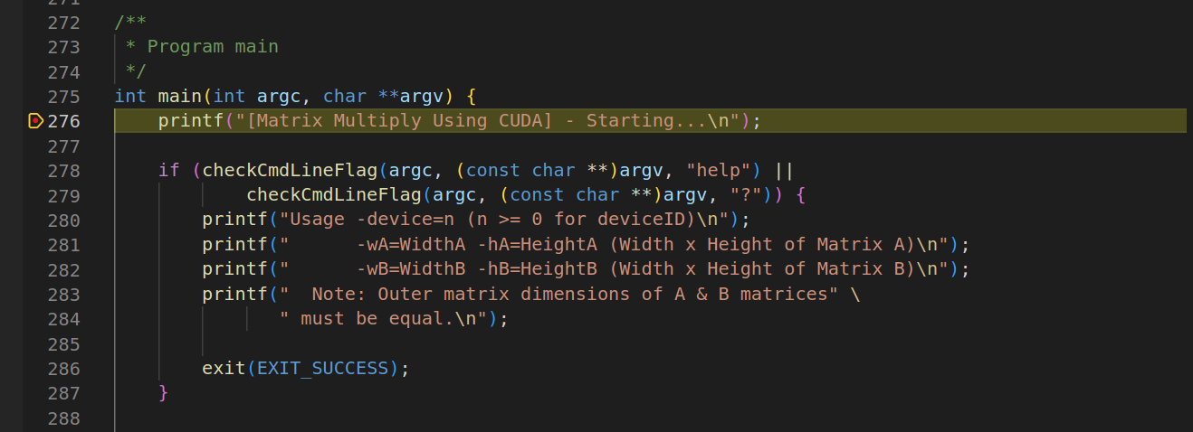

I set up my jetson nano with the sdk manager and installed JetPack 4.6.1. Further more I tried to debug the matrix multiplication example within visual studio code and run into the following error:
cuda-gdb/7.12/gdb/infrun.c:2795: internal-error: resume: Assertion `pc_in_thread_step_range (pc, tp)' failed.

first of all I want to have the single step feature of the debugger like shown in the picture below.
Second I already created the debug release by configuring the tasks.json:

In general the single step feature works until step 3 and then crashes with the error mentioned above. So back to my question:

can you check if cuda-gdb straight from the terminal works ok (and post output here) and you can try setting the breakpoint on Cuda Code instead of CPU to check as well.
Want to find out if issue is VSC plugin.

(cuda-gdb) break matrixMul.cu:276
Breakpoint 1 at 0x928c: file matrixMul.cu, line 276.
(cuda-gdb) run
Starting program: /media/nvnano/SD-Card/cuda-10.2/samples/0_Simple/matrixMul/matrixMul
[Thread debugging using libthread_db enabled]
Using host libthread_db library "/lib/aarch64-linux-gnu/libthread_db.so.1".
Breakpoint 1, main (argc=1, argv=0x7ffffff2f8) at matrixMul.cu:276
276	    printf("[Matrix Multiply Using CUDA] - Starting...\n");
(cuda-gdb) next
278	    if (checkCmdLineFlag(argc, (const char **)argv, "help") ||
(cuda-gdb) next
291	    int dev = findCudaDevice(argc, (const char **)argv);
(cuda-gdb) next
0x0000007fb7d4d784 in _dl_catch_exception () from /lib/aarch64-linux-gnu/libc.so.6
(cuda-gdb) next
Single stepping until exit from function _dl_catch_exception,
which has no line number information.
0x0000007fb7fe2418 in _dl_find_dso_for_object () from /lib/ld-linux-aarch64.so.1
(cuda-gdb) next
Single stepping until exit from function _dl_find_dso_for_object,
A problem internal to GDB has been detected,
further debugging may prove unreliable.
Quit this debugging session? (y or n)
The debugger started from the terminal crashes too. What should I do?
