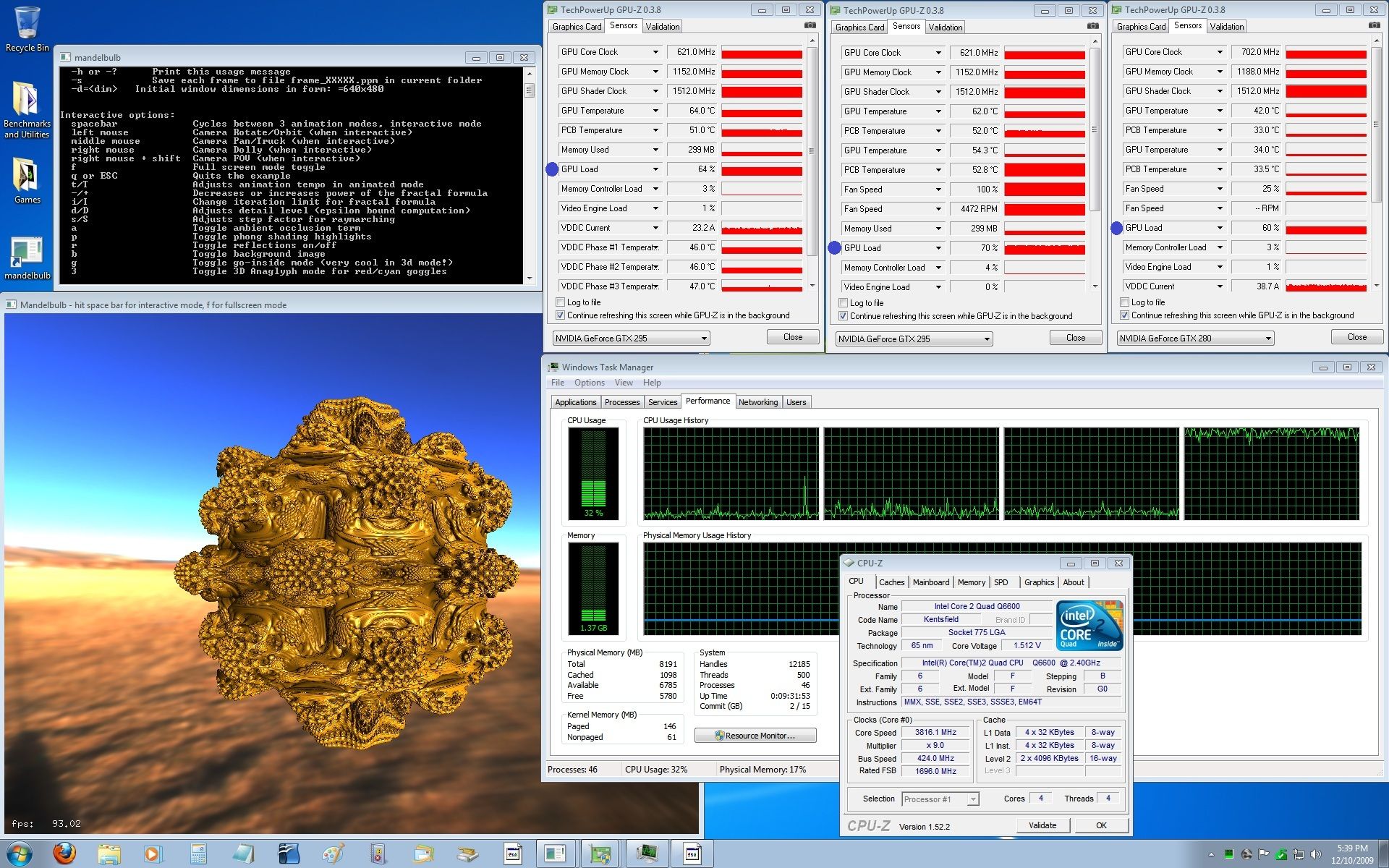

You should call cudaSetDevice (int device) function to set device to be used for GPU executions.
Question: Have you tried running an actual CUDA app that supports multi-GPU’s, or just thinking that it doesn’t support CUDA due to GPU-z?
My GTX 280 Dedicated PhysX processor looks like this in GPU-z:
Note the CUDA box does not have a check mark.
None the less, when I run a CUDA app that uses the Optix libraries, which does support multi-GPU’s, my 280 is indeed used by the app.
You may just have a wrong impression due to GPU-z?
Further, Direct Compute apps that support Multi-GPU’s also use my 280 successfully.
