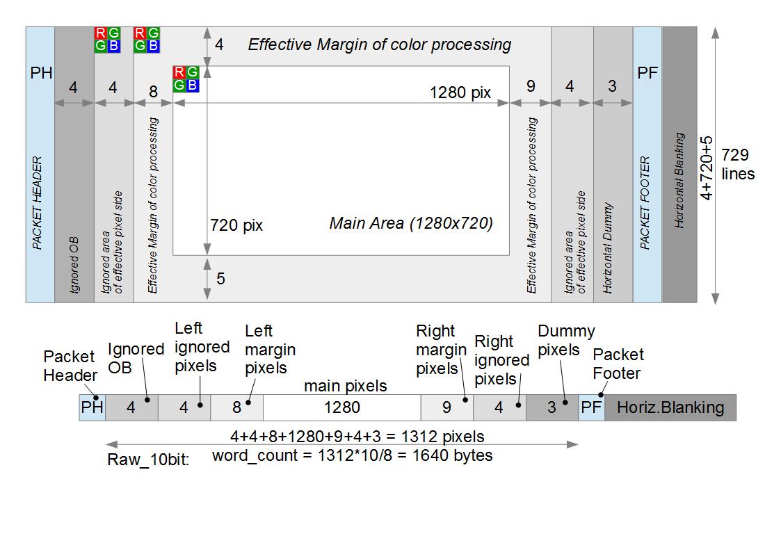

Dear Sirs. We need your assistance.
There are custom carrier board for JetsonTX1 module and custom camera board with CSI-2 sensor.
[url]http://i.imgur.com/vl7KgbZ.jpg[/url]
The driver was created according to L4T-docs(24.2.1) chapter “Sensor Driver Programming Guide” (based on OV5693 example).
We can see image(extracted from raw bayer data) from sensor
[url]http://i.imgur.com/sI03bH4.png[/url]
There are problems:
  1. The alternation of empty(zero) and normal(full) frames is observed.

Please, help. Can you check our DeviceTree dtsi-file (see below)? How to fix these problems?
Lane clock osc is continuous (HP, differential state always), Lane data osc has HP<>LP transitions.
Module pins: G24: CSI2_CK_N ; G25: CSI2_CK_P ; F25: CSI2_D0_N ; F26: CSI2_D0_P ; H23: CSI2_D1_N ; H24: CSI2_D1_P ; H8: SENSOR_RESET ; C6: I2C_SCL ; D6: I2C_SDA
Master clock is not used, because sensor module has onboard 27MHz clock-gen. Power control is not used, because camera supply is always on. Only reset line control is used for sensor startup. Camera module has no EEPROM, so we include dtsi-file manually (see patches below). Sensor has no onboard ISP, so the output is only RawBayer. We need to utilize TX1 ISP for ‘Raw->NV12’ conversion. Does ‘nvcamerasrc’ do this automatically without any configs?
‘drivers/media/platform/tegra/camera/camera_common.c’ has no support for 12bit mode, see the end of “camera_common_try_fmt”. It return -22(-EINVAL) for V4L2_MBUS_FMT_SRGGB12_1X12. See patch below.

I solved the problem about alternating blank/full frames and I got a series of full only raw bayer images using other settings(Width,Height,WordCount in csi regs).
Here is result:
http://i.imgur.com/bzZ7vOT.jpg
But now there is a problem with image resolution mismatch. Please, help me.
There are two types of resolution (in my case):
*) Capture image resolution = 1280x720@16bit (is what I want to set in capture command, is what I want to see at output)
*) CSI-2 frame resolution = 1312x729@10bit (it includes color processing margin, ignored OB data etc).
Please, see my sensor CSI-2 frame structure here:
In my case, there is only one correct set of values for csi-2(10bit).
Width=1312
WordCount=1640
Height=729
If I set WordCount other then 1640, the capture fails.
If I set Width or Height other then 1312x729, I see errors like “line is too short/long” or “frame height is too short/long” in ‘TEGRA_VI_CSI_ERROR_STATUS’ register
(Tegra X1 TRM name is 31.7.27 ‘VI_CSI_0_ERROR_STATUS_0’ page 2538).
There is only one place where the registers are set. It’s ‘drivers/media/platform/tegra/camera/vi2_fops.c’ function ‘vi2_channel_capture_setup’.
Here is we can see settings for ‘TEGRA_VI_CSI_IMAGE_SIZE’ (TRM 31.7.7 page 2534) and ‘TEGRA_VI_CSI_IMAGE_SIZE_WC’(TRM 31.7.8)
Just for testing I hardcoded these settings inside this func:
//inside 'vi2_channel_capture_setup()', just for test
    height=729;
    width=1312;
    word_count=1640;
  //word_count=1312*10/8=1312*5/4=1640
    vi2_channel_csi_write(chan, index, TEGRA_VI_CSI_IMAGE_SIZE_WC, word_count);
  //CSI frame size Width=1312, Height=729 (but capture frame size is 1280x720)
    vi2_channel_csi_write(chan, index, TEGRA_VI_CSI_IMAGE_SIZE, (height << IMAGE_SIZE_HEIGHT_OFFSET) | width);
So it works for CSI-2 and ‘TEGRA_VI_CSI_ERROR_STATUS’ has zero(non-error) status. And captured raw video has 1280x720 resolution with series of full frames output.
But csi-2 1312x729 resolution now conflicts with capture 1280x720 res.

Hi senchuss
Seems this sensor always output 1312x796, the solution should be get the 1312x796 and post process as what you want.
