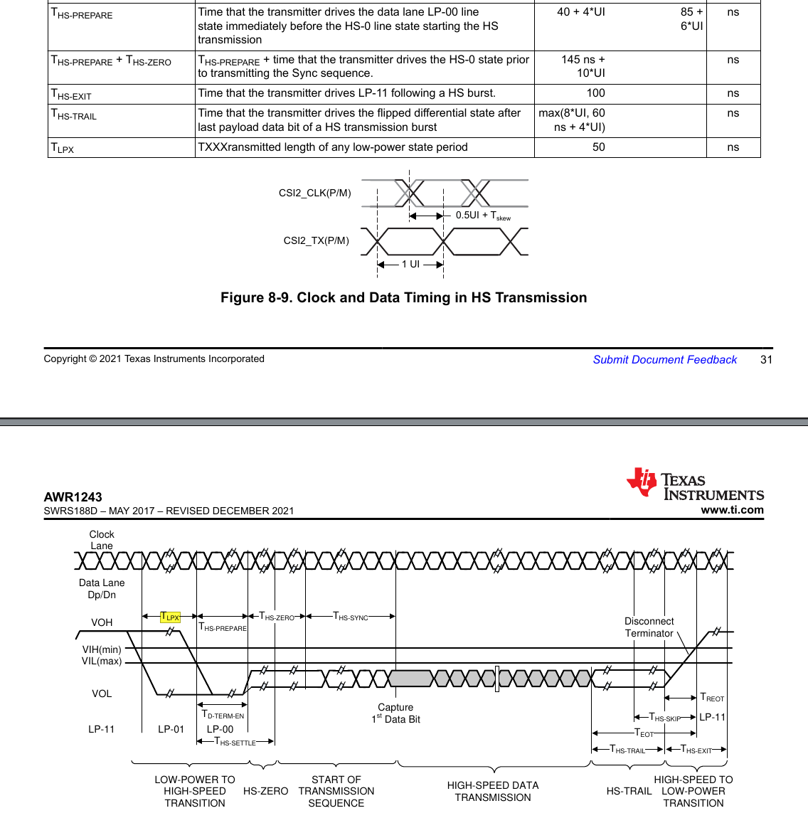

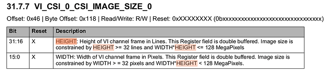

The status are 0 that could be incorrect port-index in device tree or sensor didn’t output signal to Nano.
Hi ShaneCCC,
thanks to your input I obtained a different error.
[  221.878968] video4linux video0: frame start syncpt timeout!0
[  221.886633] video4linux video0: TEGRA_VI_CSI_ERROR_STATUS 0x00000000
[  221.886669] vi 54080000.vi: TEGRA_CSI_PIXEL_PARSER_STATUS 0x00000000

Furthermore, this is what the sensor device datasheet reports for MIPI timing:
It just seems to be compliant to the standard.
I don’t think I can adjust anything there…
Thanks for your support.
Andrea

EDIT: found the static const struct camera_common_frmfmt struct from which it reads the values.
Fixed to the correct 514 - 128.
Now I get this error once per second (1fps):
[  111.779217] video4linux video0: frame start syncpt timeout!0
[  111.784920] video4linux video0: TEGRA_VI_CSI_ERROR_STATUS 0x00000004
[  111.784927] vi 54080000.vi: TEGRA_CSI_PIXEL_PARSER_STATUS 0x00000080
[  111.784931] vi 54080000.vi: TEGRA_CSI_CIL_STATUS 0x00000000
[  111.784935] vi 54080000.vi: TEGRA_CSI_CILX_STATUS 0x00000000
which means:
PPA_SHORT_FRAME: Set when CSI-PPA receives a short frame.
This bit gets set even if CSI_PPA_PAD_FRAME specifies that short frames are to be padded to the correct line length.

Seems to me that the minimum atomic increment it can handle is 32 pixels, just like 32 is the minimum width/height acceptable as reported in the TRM ((512+32)*2=1088).
What if I have a non 32-multiple amount of pixels?
