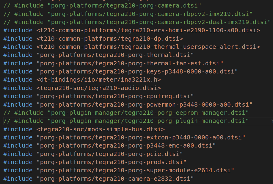

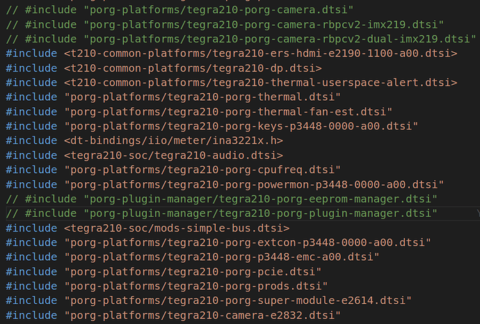

In the tegra210-porg-p3448-common.dtsi,I modify like that
tegra210-camera-e2832.dtsi is modified from the sampe dti

I don’t know if it’s all right.
Does it connect to which csi? It’s confuse for the tegra_sinterface = “serial_a” and port-index
It connect to csi4 and 4lanes. Nano
I changed it to tegra_sinterface = “serial_e”, but it is the same error.
The error is about the MIPI signal doesn’t matter with dts configure. Maybe need to check with vendor for the sensor initial REG table.
Through the log, Is the setting of jetson nano correct?First, I juest want to comfirm the setting(csi4, YUV422_8bit). If the setting of nano is all right. I will check with vendor.
Didn’t find any incorrect for the dts configure.
