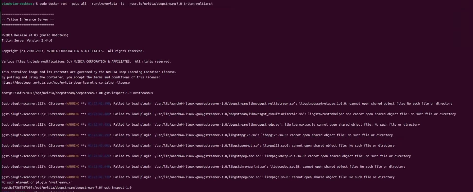

Hi, I’m using the nvcr.io/nvidia/deepstream:7.0-triton-multiarch container, but I noticed that nvstreammux is not available. I also tried installing DeepStream 7.0 directly on the host, but nvstreammux is still missing.
Is there something I’m missing? Do I need to install additional plugins or use a different container or installation method to get nvstreammux?
  1. the docke start cmd is isconsistent with the doc. please use the method in the doc.
  2. If the issue persists, could you share the result of “gst-inspect-1.0 nvstreammux” and “ldd /opt/nvidia/deepstream/deepstream/lib/gst-plugins/libnvdsgst_multistream.so”?
  1. I ran this command “sudo docker run -it --rm --runtime=nvidia --network=host -e NVIDIA_DRIVER_CAPABILITIES=compute,utility,video,graphics --gpus all --privileged -e DISPLAY=$DISPLAY -v /tmp/.X11-unix:/tmp/.X11-unix -v /etc/X11:/etc/X11 nvcr.io/nvidia/deepstream:7.0-triton-multiarch”, but it still cannot find “nvstreammux”
  1. below is the result of ldd link
root@yian-desktop:/opt/nvidia/deepstream/deepstream-7.0# ldd /opt/nvidia/deepstream/deepstream/lib/gst-plugins/libnvdsgst_multistream.so

from the log, libgstnvdsseimeta.so can’t be found. can you find this lib in the host with find / -name “libgstnvdsseimeta*” 2>/dev/null?
I couldn’t find libgstnvdsseimeta* either on the host or inside the container.
I’m wondering — does the container rely on some libraries being present on the host for everything to work properly?
In other words, do I need to install certain libraries on the host to make sure the container has everything it needs?
This lib libgstnvdsseimeta.so is in Jetpack. did you install successfully JetPack 6.0 GA according to the doc for DS7.0? could you share the result of “sudo apt-cache show nvidia-jetpack”?
Since this so is in Jetpack and not part of DeepStream. I suggested copying from othe devices or reintalling Jetpack by referring to the doc above. Thanks!
