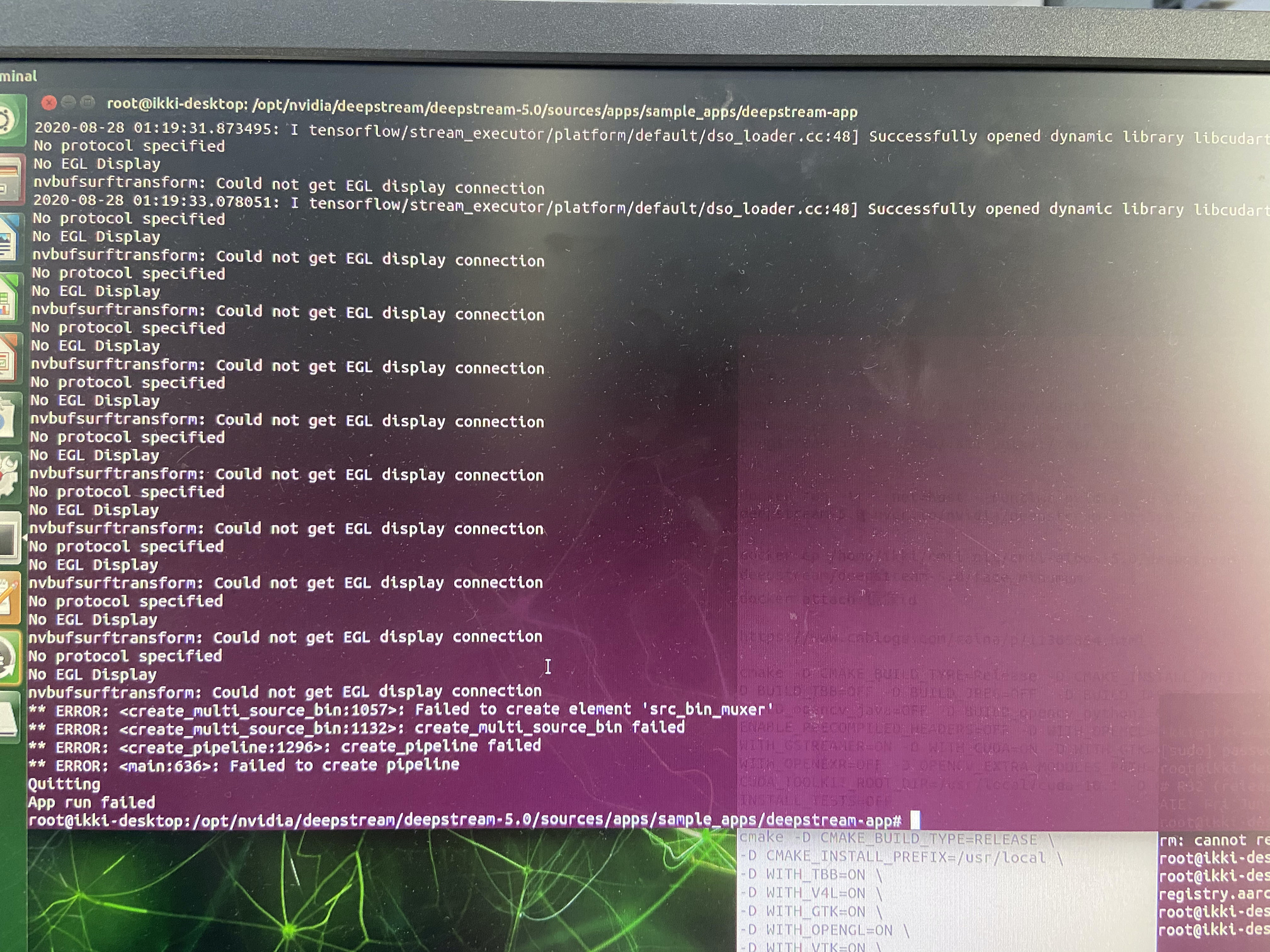

I executed the deepstream docker image deepstream-l4t:5.0-20.07-samples in jetson nano, and the running program always prompts “Failed to create element’src_bin_muxer’”, but I have deleted /root/.cache/gstreamer-1.0/ It still doesn’t work, how can I fix it? Thank you

Hello, I have upgraded to jetpack4.4 GA, but when I run the image program of the docker container, the above problem will still be prompted。
could you tell us how to repro this?
Inside docker, enter /opt/nvidia/deepstream/deepstream-5.0/sources/apps/sample_apps/deepstream-app, execute “make” and execute ./deepstream-app -c …/…/…/. ./samples/configs/deepstream-app/source8_1080p_…fp16_nano.txt, the following error will be displayed:
No EGL Display.
Did you follow the docker guidance and run “xhost+” ?
I did not run xhost+ because I used an external rtsp camera. Can I ignore the “No EGL dispaly” problem above and focus on the “Failed to create element’src_bin_muxer” problem?
I think I found the problem. When I use the docker run command, the -v parameter needs to specify the mount directory of the host. I modified it to a directory that I can run to mount, and it can run normally, thank you
