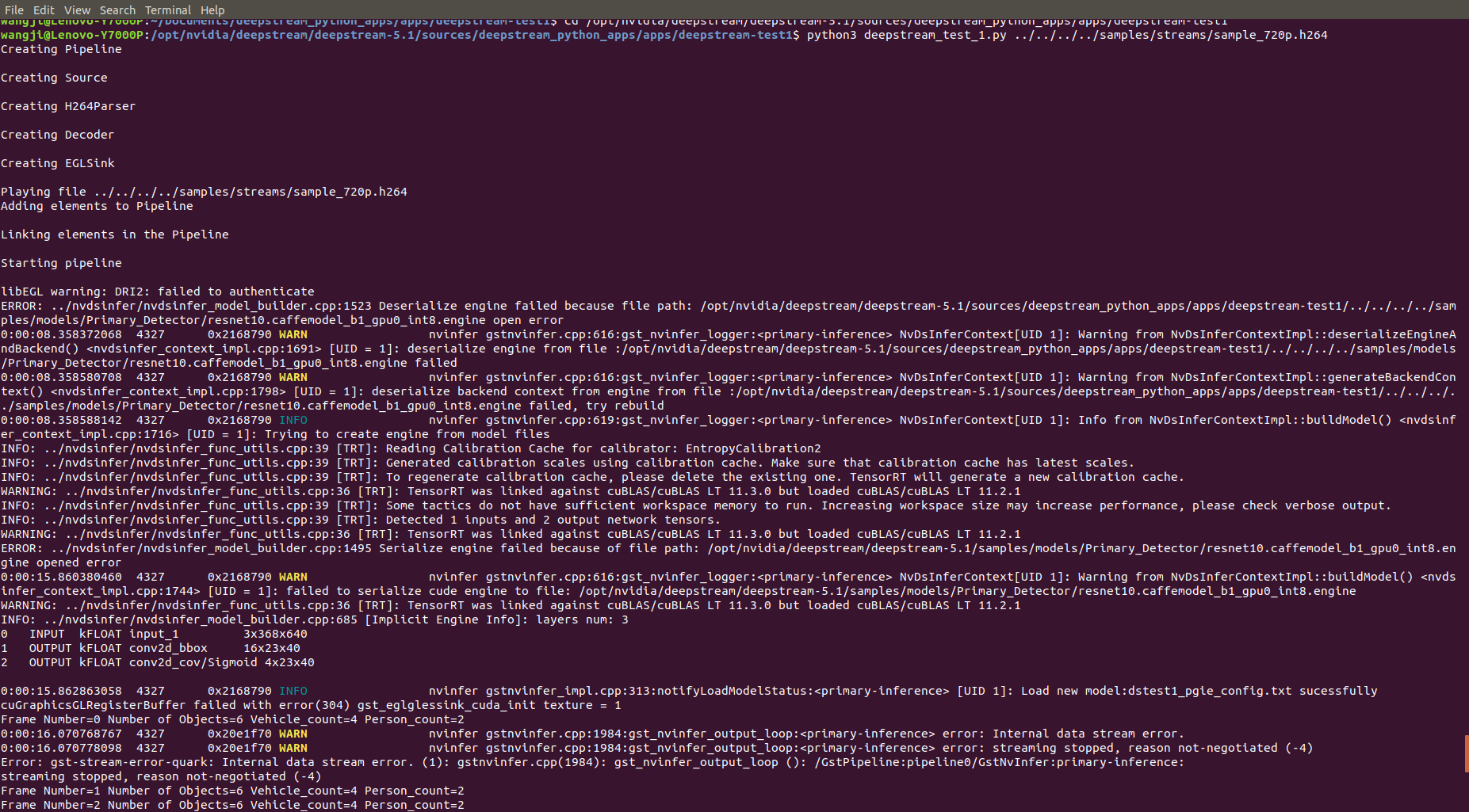

I’m moving Deepstream python programs from Jetson Xavier NX to X86 platform. I tried 2 Deepstream python programs on X86, and both run error, but they can run on Jetson well.
  1. program No.1, just deepstream-python-app test1. I didn’t modify the code of it.
    The screenshot of error is below:

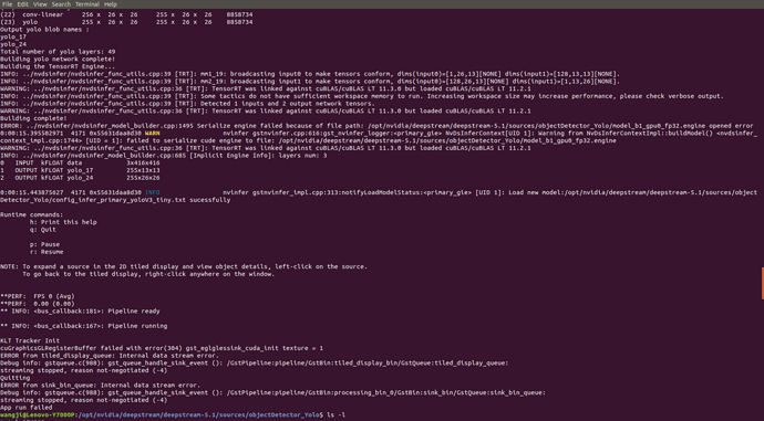

  1. program No.2. I use TLT Peoplenet34 model, and also failed.
How can solve it, many thanks.

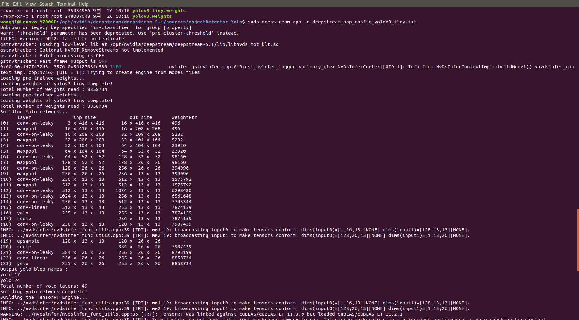

BTW, I also run “deepstream-app -c deepstream_app_config_yoloV3_tiny.txt” command, and the error is “Internal data stream error” , same as python deppstream-test1 app.
I saw there is error below.

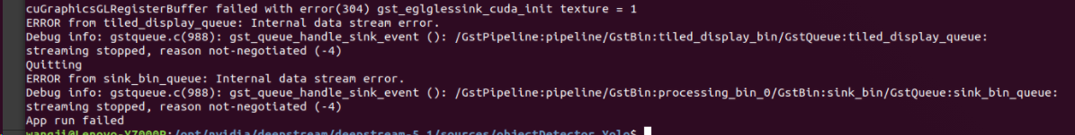

there is error - “cudagraphicsglregisterbuffer failed with error 304”, seems the same as cuGraphicsGLRegisterBuffer failed with error(304) gst_eglglessink_cuda_init texture =1 - #12 by Amycao

I changed the gstreamer pipeline of python deepstream-test1 from nvosd → nveglglessink to nvosd → nvvidconv → xvimagesink, then the program run well on my X86 laptop.
The problem maybe happened on the nveglglessink element, and maybe some related libs are not linked.
I will keep trying to move my others python deepstream programs from Jetson to X86 platform.
Can you pls. kindly help to give me some tips about the root cause?
many thanks.
xvimagesink is CPU based plugin, while nveglglessink is GPU based .
So, I think it’s still some issue with your GPU driver
