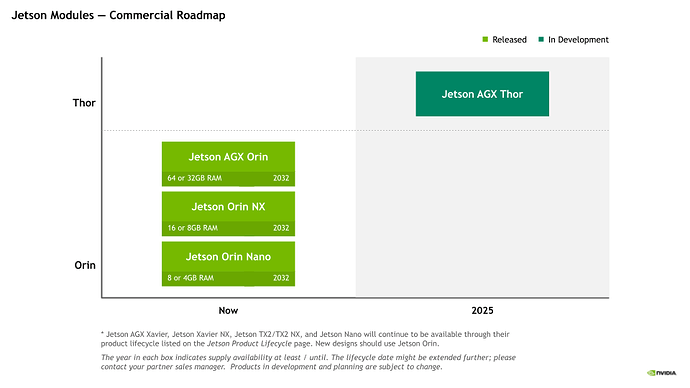

Can we get a hint on timeframe? Would it be measured in weeks or months? With no Blackwell Jetsons, is this a generation that could be skipped? Do we have to wait for Rubin?
Blackwell Jetson(Jetson Thor) is supposed to be released later this year sometime:
Oh, I didn’t know that and it does narrow things down a bit. It would almost need to be less than 7 months away.
Is there an expected release timeframe you can give us? Is it going to be Q4 of this year?
This is already the only thing we can tell you.
