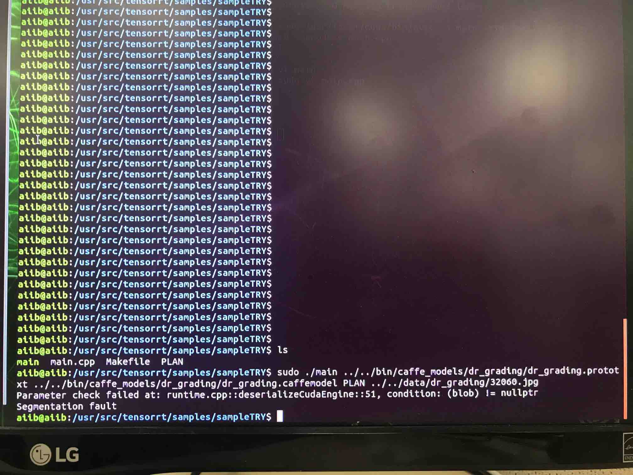

Hi Aasta,
It’s a clear sample, I am re-developing our case according to this sample.
Can you explain the ARGV[3], namely PLAN, really means? and give us a real instance of the PLAN ?

It is a TensorRT serialized filename.
For the 1st run, we serialize TensorRT engine to the filename.
From 2nd run, we deserialize TensorRT engine from the filename.

Please see below attachment for the errors when running the sample in #27
It looks like your PLAN file is broken. Maybe you can check the status of memory/storage?
To give a further suggestion, could you attach the dr_grading.prototxt/dr_grading.caffemodel/PLAN file with us?
Could you give us a PLAN file for reference now?
I just create an empty file and rename it to PLAN.
The caffemodle cannot be shared now, hope you can understand
