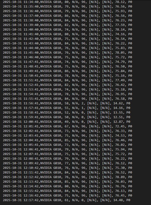

..However , far more worrying is the thermal throttling behaviour after even modest loads. This is getting in to ‘ i want my money back territory’. How does everyone else feel about this?
@Nvidia please respond . Something tells me that a firmware upgrade is not going to solve thermal overload issues - But what about giving us a big heatsink or something? the unit is on a table and there is adequate airflow around it. However ive no idea if the device even has a fan inside it. Here is what Claude said after a basic test:

Update: i got a response from Nvidia techsupport:
If you were to monitor free -h you would see file system cache filling up memory. Between clips you can run sudo sync && echo 3 | sudo tee /proc/sys/vm/drop_caches > /dev/null from a shell window to empty the file system cache. You will get back all the performance.

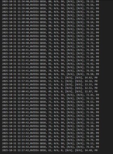

So i did this and yes it helped. Here are some of the temperature results and time to render 5s video clips, after using the suggested cache clearing above: the available memory didnt change much so i dont understand the significance of that. Temperature hit 86 deg.
here are the screenshots:
If it doesn’t reload model between clip generations, clearing cache is pointless, because the model will be still be in memory. Cleaning cache helps only when you need to load the model again. Due to how unified memory is handled by the driver, most existing software will see cached memory as not available, even though it is actually available to load models. So, clearing caches is just to ensure that software can see correct amount of available GPU memory, that’s all.
I am glad you were able to increase your performance. Just to be clear, we do not have thermal limits on the DGX Spark, and the temperature readings you show are well within limits for a GPU under stress.
I would like to know, if this is an intended behaviour and if, what is it’s purpose? Further I don’t understand how and why the cache (on ssd storage) affects computing. Default behaviour should be as expected - without any impact, or am I mislead anyhow? Just curious…
