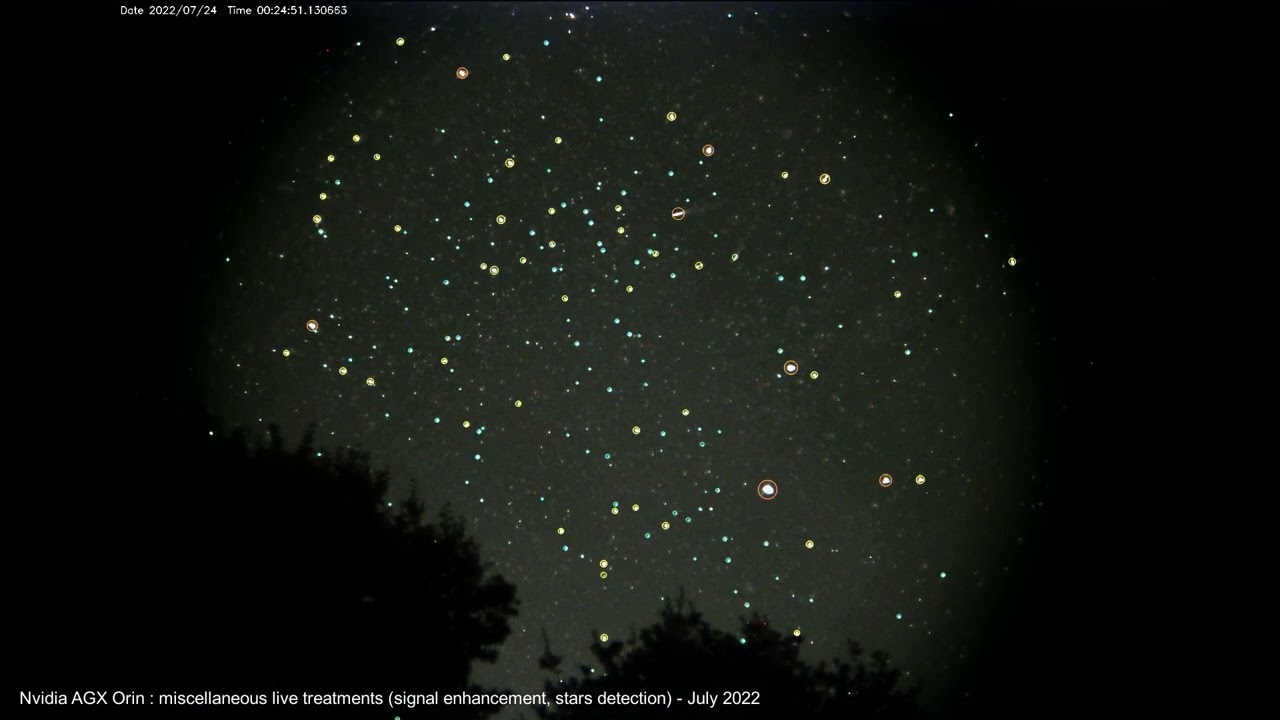

i made new test yesterday at night.
Jetson AGX Orin was used for camera setup/control and live treatments (no post treatments).
I used 3 different lens with the camera :
  • 8mm f1.0
  • 50mm f1.4
  • 135mm f2.5
The target was the Milky Way (looking to the north, north-east, east.
The sky was quite good. This is interesting because i was able to see things like NGC 7000 (the North America Nebula). It is really cool to start to see deep sky structures with colours (you can really see the colours with your naked eyes).
The video :
This test was really cool. It’s really great to see space objects with live video. Really impressing.
My lens are not open enough (f1.4 is not enough and f2.5 is far too much for live view with quite short exposure time).
I will try to find a solution to get something like 33 or 50mm focal length with f0.95 aperture. If i can get something like that i can plug on my camera, it will be terrific.
That’s too bad Jensen Huang do not have time to make astronomy. He could get a very good camera and a NIKKOR Z 58mm f/0.95 lens. With this equipment and a good sky, the result would be really incredible.
I would like to insist on 1 or 2 points :
  • for sure i have to push camera gain really high but you must really consider that without live treatments, you could never see so much details in the video and the signal would be really noisy (much more noisy)
  • this video is quite unique from what i know. You won’t see such video anywhere else (you will find for sure timelapse but with long exposure ; in my case, the exposure time is from 200 to 500ms max).
