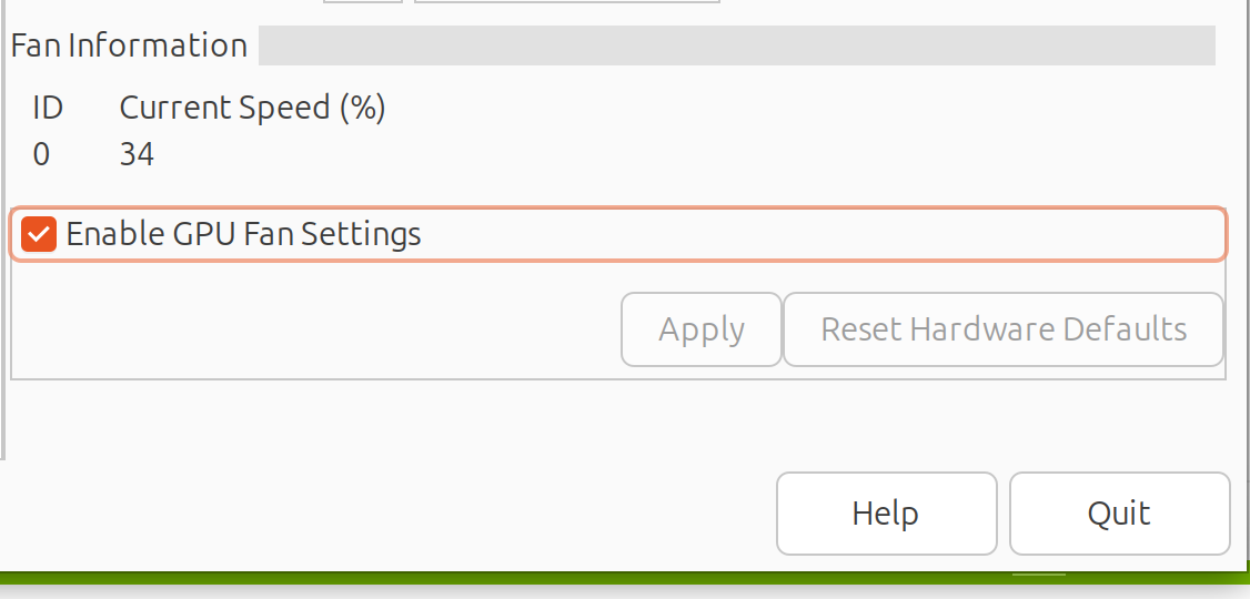

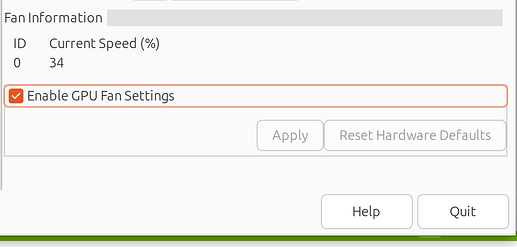

Confirmed. I’m able to enable “GPU Fan Settings” only when I run sudo nvidia-settings in Wayland.
Now I’m getting this fan information (even when a run nvidia-settings as a normal user)
Not sure it’s normal that e.g. I can’t change fan speed nor can’t see RPM speed, but it might be a limitation of my card (MSI GeForce RTX 4060 VENTUS 2X BLACK 8G OC) … ?
Tested in Ubuntu 24.04, with nvidia driver 560.35.03.
