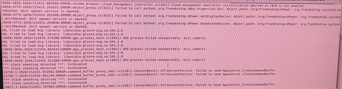

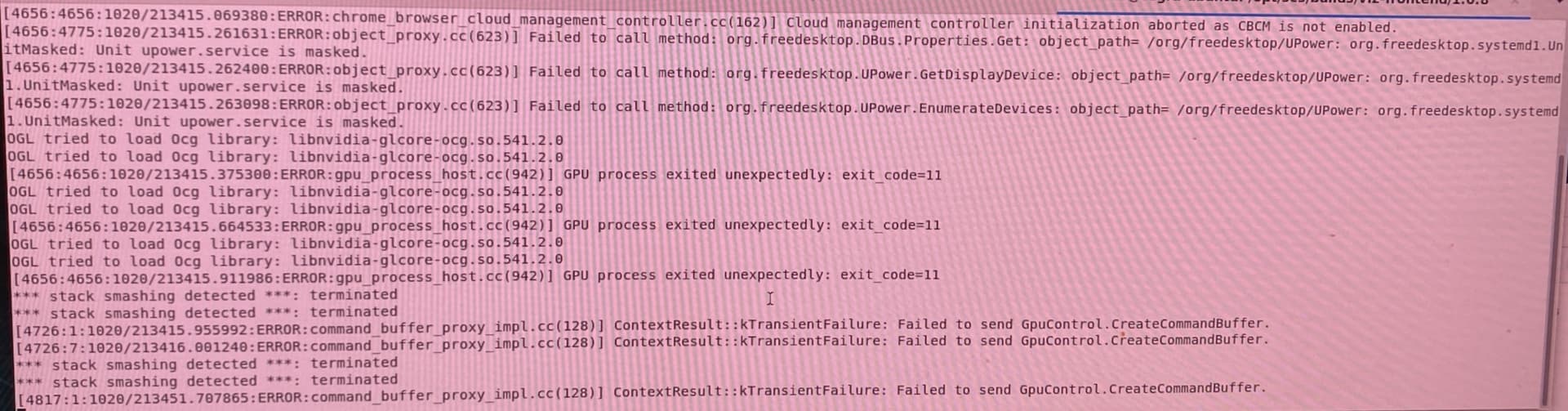

“In the Log Messages” section of chrome://gpu, we see the following errors when running the GUI:
  • GpuProcessHost: The GPU process crashed!
  • [2888:2888:1020/211508.609901:WARNING:sandbox_linux.cc(393)]: InitializeSandbox() called with multiple threads in process gpu-process.
Here is the Chromium output on the console:
Does all this indicate that the GPU is being used, but something is preventing it from operating normally?
We found that using the command line option –disable-gpu-sandbox for Chromium both enables hardware acceleration for most features and resolves all of the error messages logged on the chrome://gpu page.
