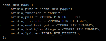

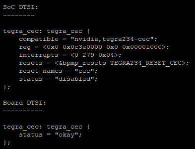

I have one more question about enabling HDMI.
I found nvidia,tegra234-cec.txt under sources/kernel/nvidia/Documentation/devicetree/bindings/misc/tegra-cec/.
Do I need to set this configuration for enabling HDMI?
And where I put those in, If I need?
No, CEC has nothing to do with HDMI bring up. It is just one function but not mandatory.
