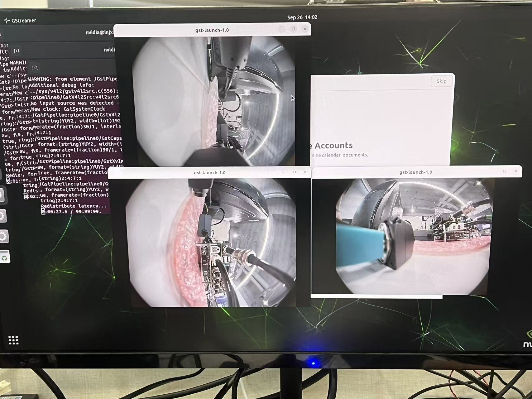

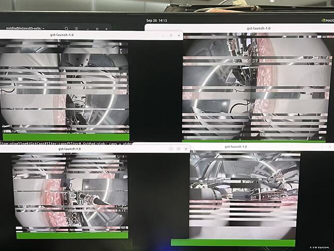

When I only enabled the data streams of three cameras, previewing all three cameras was normal. But when I enabled the data streams of four cameras, I found that there were stripes and partitions when previewing the cameras. However, when I added the serdes_pix_clk_hz configuration in dts, all the cameras could no longer be previewed
Try boost the clocks to verify the stripes problem instead of add added the serdes_pix_clk_hz for JP6.

This configuration has already been enabled; otherwise, normal preview is not possible
It was precisely because I could preview three cameras normally (each camera is 462M/lane, and 3g is less than 1.5G), but four were abnormal, that I thought I needed to configure serdes_pix_clk_hz
What’s the output size and frame rate?
1920*1536 30fps format=YUY2
If you have boost the clock that doesn’t help then add the serdes_pix_clk_hz wouldn’t help on it too.
Could you decrease the frame rat to verify.
The frame rate cannot be reduced because the camera data is directly output by YUV. I cannot control the resolution and frame rate to decrease the CSI data
Does the open sequence does matter with the problem?
Sorry, I can’t understand what you mean
The camera launching order. Like open 1 →2 →3 →4 or 4→3→2→1 ..
I haven’t tried reverse opening (4>3>2>1) yet. I’ll give it a try first
it doesn’t matter the open order
Do these four cameras connect to the same CSI brick?
yes,These are connected the same MAX96712, then the MAX96712 are connected orin A port 4lane CSI [ 67.941608] [RCE] NVCSILP clock rate = 408000000 Hz.

I would suspect could be the max96712 bandwidth cause the problem.
