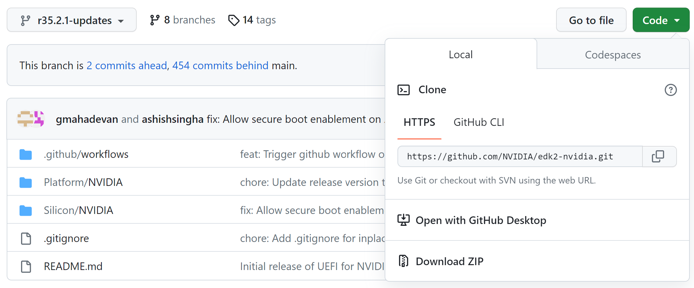

What’s your current Jetpack version in use for AGX Orin?
Have you refer the following instruction to install mono?
edk2-pytool-extensions/using_extdep.md at tianocore/edk2-pytool-extensions · GitHub
Could you help to run the following command to clone the UEFI source?
$edkrepo clone nvidia-uefi-r35.3.1 NVIDIA-Jetson r35.3.1
Thank you, the board was designed by oneself.
Because we will use soft version r35.2.1 not r35.3.1, I change the command:
$edkrepo clone nvidia-uefi-r35.2.1 NVIDIA-Jetson r35.2.1
But the fetch failed error was prompted,log is here:

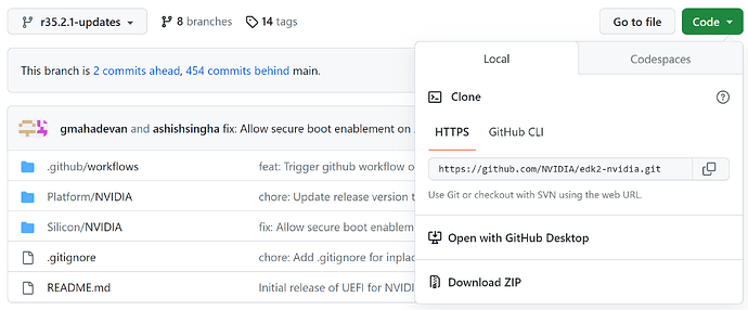

Or could you try to download the .zip from GitHub?
Yes,I can manually download it from Github,.
But is there a link? Where is the placement path?
You can choose branch to r35.2.1-updates , select Code → Download ZIP as following.
There will still be the same mistake.

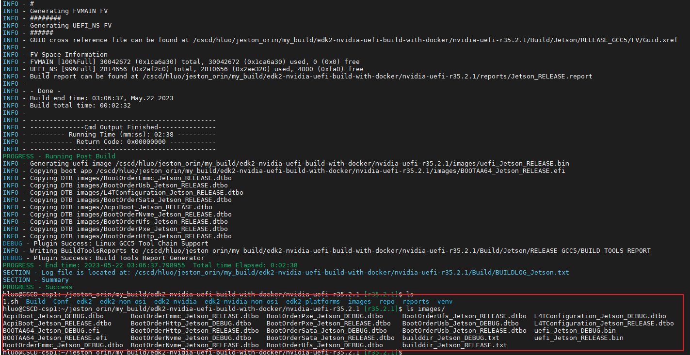

In the same environment, I can use the docker method to complete compilation
I can even see the download of these two dependent prints.
Although I can now see the compiled image, I am a bit confused and don’t know why non-docker compilation methods cannot be downloaded.

hluo@CSCD-csp1:~/jeston_orin/my_build/edk2-nvidia-uefi-build-with-docker/nvidia-uefi-r35.2.1 [r35.2.1]$ ls
1.sh Build Conf edk2 edk2-non-osi edk2-nvidia edk2-nvidia-non-osi edk2-platforms images repo reports venv
hluo@CSCD-csp1:~/jeston_orin/my_build/edk2-nvidia-uefi-build-with-docker/nvidia-uefi-r35.2.1 [r35.2.1]$ ls images/
AcpiBoot_Jetson_DEBUG.dtbo BootOrderEmmc_Jetson_RELEASE.dtbo BootOrderPxe_Jetson_DEBUG.dtbo BootOrderUfs_Jetson_RELEASE.dtbo L4TConfiguration_Jetson_DEBUG.dtbo
AcpiBoot_Jetson_RELEASE.dtbo BootOrderHttp_Jetson_DEBUG.dtbo BootOrderPxe_Jetson_RELEASE.dtbo BootOrderUsb_Jetson_DEBUG.dtbo L4TConfiguration_Jetson_RELEASE.dtbo
BOOTAA64_Jetson_DEBUG.efi BootOrderHttp_Jetson_RELEASE.dtbo BootOrderSata_Jetson_DEBUG.dtbo BootOrderUsb_Jetson_RELEASE.dtbo uefi_Jetson_DEBUG.bin
BOOTAA64_Jetson_RELEASE.efi BootOrderNvme_Jetson_DEBUG.dtbo BootOrderSata_Jetson_RELEASE.dtbo builddir_Jetson_DEBUG.txt uefi_Jetson_RELEASE.bin
BootOrderEmmc_Jetson_DEBUG.dtbo BootOrderNvme_Jetson_RELEASE.dtbo BootOrderUfs_Jetson_DEBUG.dtbo builddir_Jetson_RELEASE.txt
