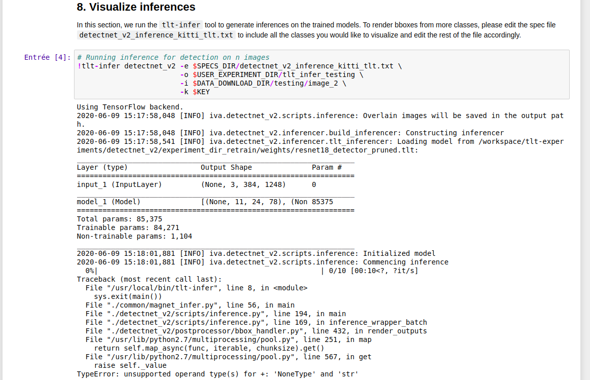

Error while using Tlt-infer
Hi everyone, I’m training a Detectnet_v2 model on Tlt and apparently everything went fine until the inference command it shows this
My goal is to train a model to use in Isaac SDK so I’m following its tutorial
I can’t put my spec file as a new user but I checked it many times and it looks fine because I only used the default config unless this error means there is something wrong with it
I don’t know what to do can anyone help me please
Could you please paste your detectnet_v2_inference_kitti_tlt.txt here?

In your config file, I can see there are 11 classes.
But actually how many classes did you train?
Also, in default config file inside the docker, there is an issue for car/cyclist/pedestrian. The key does not match output_map.
key:“car”
value: {
confidence_model: “aggregate_cov”
output_map: “person”
should be
key:“car”
value: {
output_map: “car”
Please modify the three classes.
I changed the output_map but the error persist, I trained 11 classes, although some of them are with 0 precision
Here is my spec file for training, for retraining it’s basically the same

minimum_detection_ground_truth_overlap {
key: “pallet”
value: 0.5
key: “floordecale”
value: 0.5
key: “extinguisher”
value: 0.5
evaluation_box_config {
key: “car”
value {
minimum_height: 20
maximum_height: 9999
minimum_width: 10
maximum_width: 9999
key: “cyclist”
value {
minimum_height: 20
minimum_width: 10
maximum_width: 9999
key: “pedestrian”
value {
minimum_height: 20
minimum_width: 10
maximum_width: 9999
key: “dolly”
value {
minimum_height: 20
minimum_width: 10
maximum_width: 9999
key: “cardbox”
value {
minimum_height: 20
minimum_width: 10
maximum_width: 9999
key: “trafficcone”
value {
minimum_height: 20
minimum_width: 10
maximum_width: 9999
key: “wetfloorsign”
value {
minimum_height: 20
minimum_width: 10
maximum_width: 9999
key: “lampceiling”
value {
minimum_height: 20
minimum_width: 10
maximum_width: 9999
key: “pallet”
value {
minimum_height: 20
minimum_width: 10
maximum_width: 9999
key: “floordecale”
value {
minimum_height: 20
minimum_width: 10
maximum_width: 9999
key: “extinguisher”
value {
minimum_height: 20
minimum_width: 10
maximum_width: 9999
average_precision_mode: INTEGRATE
cost_function_config {
target_classes {
class_weight: 1.0
coverage_foreground_weight: 0.0500000007451
objectives {
initial_weight: 1.0
weight_target: 1.0
objectives {
initial_weight: 10.0
weight_target: 10.0
target_classes {
class_weight: 8.0
objectives {
initial_weight: 1.0
weight_target: 1.0
objectives {
weight_target: 1.0
target_classes {
class_weight: 4.0
objectives {
initial_weight: 1.0
weight_target: 1.0
objectives {
weight_target: 10.0
target_classes {
class_weight: 4.0
objectives {
initial_weight: 1.0
weight_target: 1.0
objectives {
weight_target: 10.0
target_classes {
class_weight: 4.0
objectives {
initial_weight: 1.0
weight_target: 1.0
objectives {
weight_target: 10.0
target_classes {
class_weight: 4.0
objectives {
initial_weight: 1.0
weight_target: 1.0
objectives {
weight_target: 10.0
target_classes {
class_weight: 4.0
objectives {
initial_weight: 1.0
weight_target: 1.0
objectives {
weight_target: 10.0
target_classes {
class_weight: 4.0
objectives {
initial_weight: 1.0
weight_target: 1.0
objectives {
weight_target: 10.0
target_classes {
class_weight: 4.0
objectives {
initial_weight: 1.0
weight_target: 1.0
objectives {
weight_target: 10.0
target_classes {
class_weight: 4.0
objectives {
initial_weight: 1.0
weight_target: 1.0
objectives {
weight_target: 10.0
target_classes {
class_weight: 4.0
objectives {
initial_weight: 1.0
weight_target: 1.0
objectives {
weight_target: 10.0
enable_autoweighting: true
max_objective_weight: 0.999899983406
min_objective_weight: 9.99999974738e-05
training_config {
batch_size_per_gpu: 10
num_epochs: 100
learning_rate {
soft_start_annealing_schedule {
min_learning_rate: 5e-06
max_learning_rate: 5e-04
soft_start: 0.10000000149
annealing: 0.699999988079
regularizer {
type: L1
weight: 3.00000002618e-09
optimizer {
adam {
epsilon: 9.99999993923e-09
beta1: 0.899999976158
beta2: 0.999000012875
cost_scaling {
initial_exponent: 20.0
increment: 0.005
decrement: 1.0
checkpoint_interval: 10
bbox_rasterizer_config {
target_class_config {
key: “car”
value {
cov_center_x: 0.5
cov_center_y: 0.5
cov_radius_x: 0.40000000596
cov_radius_y: 0.40000000596
bbox_min_radius: 1.0
key: “cyclist”
value {
cov_center_x: 0.5
cov_center_y: 0.5
cov_radius_x: 1.0
cov_radius_y: 1.0
key: “pedestrian”
value {
cov_center_x: 0.5
cov_center_y: 0.5
cov_radius_x: 1.0
cov_radius_y: 1.0
key: “dolly”
value: {
cov_center_x: 0.5
cov_center_y: 0.5
cov_radius_x: 0.4
cov_radius_y: 0.4
key: “cardbox”
value: {
cov_center_x: 0.5
cov_center_y: 0.5
cov_radius_x: 0.4
cov_radius_y: 0.4
key: “trafficcone”
value: {
cov_center_x: 0.5
cov_center_y: 0.5
cov_radius_x: 0.4
cov_radius_y: 0.4
key: “wetfloorsign”
value: {
cov_center_x: 0.5
cov_center_y: 0.5
cov_radius_x: 0.4
cov_radius_y: 0.4
key: “lampceiling”
value: {
cov_center_x: 0.5
cov_center_y: 0.5
cov_radius_x: 0.4
cov_radius_y: 0.4
key: “pallet”
value: {
cov_center_x: 0.5
cov_center_y: 0.5
cov_radius_x: 0.4
cov_radius_y: 0.4
key: “floordecale”
value: {
cov_center_x: 0.5
cov_center_y: 0.5
cov_radius_x: 0.4
cov_radius_y: 0.4
key: “extinguisher”
value: {
cov_center_x: 0.5
cov_center_y: 0.5
cov_radius_x: 0.4
cov_radius_y: 0.4
deadzone_radius: 0.400000154972
Solved, had to add output_map parameter to all the target classes
Thank you
