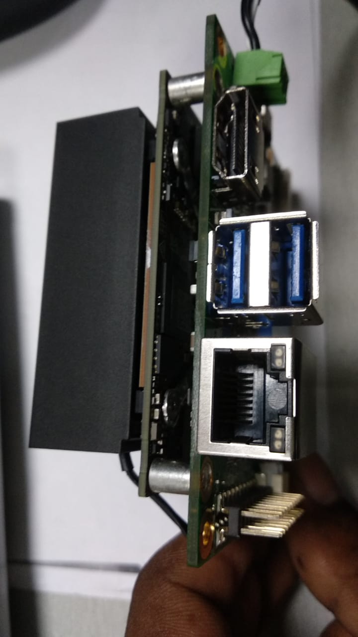

Dear Colleagues,
We are facing below issues with Xavier NX SOM Production Moudule during the functional testing process.
  1. Ethernet port is not connected and IP address is not identified. Refer attachment : Xavier NX SOM Ethernet Port Issue.pdf (attachment.zip|attachment Xavier NX SOM Ethernet Port Issue (609.0 KB) ) .
  2. Xa.NX SOM Production Module is not identified .Refer attachment :Xavier NX SOM not detecting.pdf (attachment.zip|attachment Xavier NX SOM Ethernet Port Issue (609.0 KB) ) .
    Request you to guide us to resolve this issues.
    Meantime , can anyone support us by giving the
    Problem Escalation Matrix with contact details and to get in touch with INDIA region NVIDIA technical support guys and resolve this issues .

Hi Wayne,
Please note that there is no issue in USB but Ethernet Port is having connectivity issues and the device ( IP ADD) cannot identified,
FYI- Find the attached reference.

Not sure if you notice that all of the document and pictures you are sharing don’t have a ethernet cable mentioned.
If you just cannot see the 192.168.55.x from your host, then it is usb device mode issue…
Please clarify what issue you are talking about.

Could you share me the boot up log and dmesg?
And you should also share
  1. The version of software release you are using.
  2. This issue sounds only happen to your carrier board. Could you elaborate what are A1/A2/B1/B2/B3 boards and what “patches” are needed for your board to have working etherent?
  3. Does this issue happen if you put the module on nv devkit?
Those are the real info you should share but not some unclear description.
You cannot expect other people here to understand your own project in the beginning.

serial console is not provided in the NX board please check the image
This is your own carrier board, if it does not provide a interface to dump serial console, then I cannot help you either.
Please check if you can use command ctrl + alt +f1~6 with usb keyboard and change the tty console on monitor.

Looks like the device cannot read the mac address from eeprom and cause this problem.
  1. Are you able to dump the serial console?
  2. Is there any result if you use i2cdump on i2s bus 0?
sudo i2cdump -y 0 0x50
