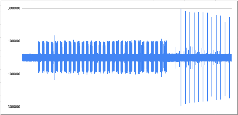

We are currently implementing an ethercat master through the ethernet port and we are seeing a strange behavior.
We use socket with raw packets to send data and receive it.
We send data at 0.8ms interval, but the problem happens at any interval.
When we send the data, the first device on the line sends back its accurate clock timestamp and we adjust our real-time loop according to it. The loop runs on an isolated core at priority 49 and is precise with a deviation of 150ns. We also brought the ethernet IRQ to the same isolated core to have better result.
However, there’s a pattern with the Ethernet port on the Orin NX and Nano that we see where the packet will be sent late, then the next packet will be sent early. It looks like something related to a kernel buffer? The send() command from socket.h is non-blocking ; it passes everything to the kernel.
We tried the code on an Orin Ethernet port, on a LAN7430 attached to a PCI lane, and a Raspberry Pi 4.
There’s only on the Orin’s ethernet port that the communication behaves in a strange manner. We tested on multiple Orin devices, and multiple ethercat slaves.

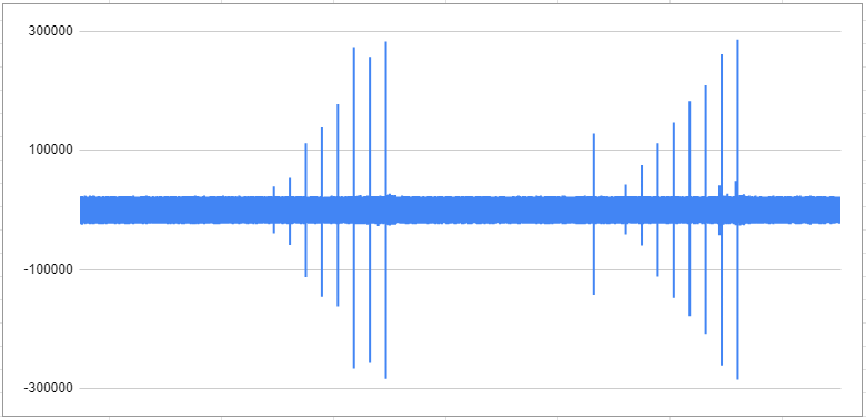

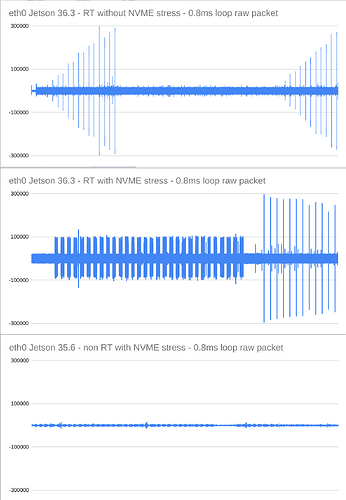

Here are graphs that shows the difference between the last received timestamp from the slave to the devices we tested on.
Is there anything I can tune on the kernel side to mitigate this problem? Is there any test I can run for you that would be able to help?
The problem occurs with the default devkit image, with and without the real-time patch.

@linuxdev
So, I monitored what IRQs were being triggered and saw that tegra-pcie-intr seems to be all bound together in the kernel.
since nvme0q0 and eth0 are tied to tegra-pcie-intr, I tried to stress the nvme ssd with stress --hdd 1 --timeout 1m -v at the same time the program was running.
Here is the graph :
Your intuition on Rescheduling interrupts seems to be right. Can Nvidia confirm this?
The cone pattern might be unrelated to this but there’s something there.

I have tried the patch on a basic sample rootfs and the RT kernel. All building steps were done from scratch.
While it has greatly increased performance, the cone shape pattern is still there, unlike in 35.6.

I send Ethercat raw packets to a slave at each 0.8ms and It returns its clock time.
The Y axis represent the deviation of a message in nanoseconds.
The X axis is the sample number.
A point represent : TimeNow-TimePrevious-0.8ms
a value of 0 is a perfect timing.
With jetson 35.6 non-RT, I have a deviation of only 16000 nanoseconds under nvme load.
With jetson 36.3 RT and the IRQ patch, I get a deviation of 2000 nanoseconds but with cone shaped spikes.
With jetson 36.3 RT, a PCI LAN7430 controller does not have spikes and have good deviation.
A spike first have a high value, then a value of almost its exact negative. Seems to me that the NIC driver sends a packet late, and tries to catchup after.
What is the result of non-RT kernel? Also, as your result, it seems indicate it is also related to the PHY in use?
LAN7430 and on-board etherent are both on PCIe but seems only the on board ethernet (r8168) has the issue?
The results of non-RT kernel on 36.3 is higher deviation and still cone shaped spikes.
On non-RT kernel for 35.6, low deviation, no spikes.

The results of non-RT kernel on 36.5 is higher deviation and still cone shaped spikes.
  1. If you are using 36.3, I would like to know if you could also test the result of 36.4.
    We have a significant change for the on-board ethernet driver between 36.4 and 36.3. I don’t guarantee it would definitely work, but as this is large change, I think it should be tested first.
Will do.
And yes, it was a typo.
The problem seems to not happend on Jetson Linux 36.4.
I get an average deviation of 500ns and a max deviation of 8200ns. That’s with the non-RT kernel

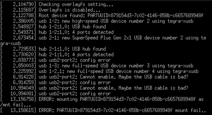

I couldn’t make the devkit boot by building a RT version, so I had to use sdkmanager to install 36.4. I then tried to install the RT packages with
sudo apt install nvidia-l4t-rt-kernel nvidia-l4t-rt-kernel-headers nvidia-l4t-rt-kernel-oot-modules nvidia-l4t-display-rt-kernel
But I get the same error as with my built image which is this :
