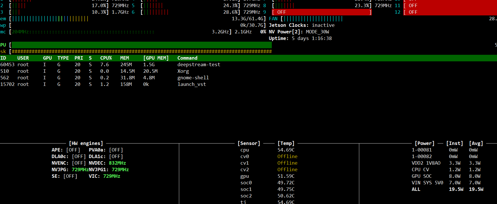

Excuse me, in the new deepstream, I added DLA support in the configuration file of Infer, but it hasn't been implemented yet
**• Hardware Platform (Jetson / GPU)6.1
**• DeepStream Version 7.1
**• JetPack Version (valid for Jetson only)6.1
**• TensorRT Version 10.3
**• NVIDIA GPU Driver Version (valid for GPU only)540.4.0
The Type of this mechine is Orin AGX 64G
Excuse me, in the new deepstream, I added DLA support in the configuration file of Infer, but it hasn’t been implemented yet
How to use models in the DLA?
file.zip (852.8 KB)
I feel that the model is not compatible with DLA
This model is GPU based,
I don’t know how to convert models based on Deepstream
The model that used trtexec to convert DLA also failed

DLA core 0 is already working properly
This model was converted to GPU, not DLA, thank you.
The configuration file above has also been added
+enable-dla=1
+use-dla-core=0

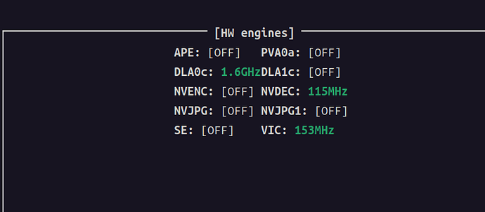

The first question is with command trtexec ,can we set batch size
The second question can we transform dla engine in the deepstream?
The first problem has been solved, there is no need to look again
Now we only need to look at the second question
The following command line is used to generate a int8 batch-size=8 engine file for the DLA0 .
You need to specify the int8 calibration file
DLA requests all profiles have same min, max, and opt value. Otherwise the generated engine file will only run on the GPU.
/usr/src/tensorrt/bin/trtexec --minShapes="input_1:0":8x3x544x960 --maxShapes="input_1:0":8x3x544x960 --optShapes="input_1:0":8x3x544x960 --onnx=/opt/nvidia/deepstream/deepstream/samples/models/Primary_Detector/resnet18_trafficcamnet_pruned.onnx --useDLACore=0 --int8 --calib=/opt/nvidia/deepstream/deepstream/samples/models/Primary_Detector/cal_trt.bin --allowGPUFallback --saveEngine=resnet18_trafficcamnet_pruned.onnx_b8_dla0_int8.engine
Please use the above configuration file to run test1, and DLA0 can be used normally
