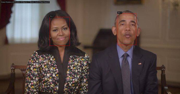

I think i am about to finish face recognition deepstream app,i used YOLOv3 as primary detector and facenet as classifier. Also used compressed dataset_embeddings.npz as my input datasets that includes photos of faces to recognized in the video. When i run the application,
i get results as shown below:
FRom the second photo, you can see that names predicted are correct. But unfortunately, the name is not shown in the first photo along the bbox instead of “face1”. How can pass that info so that it gets displayed around bbox?
Below is osd_sink_pad_buffer_probe function

return Gst.PadProbeReturn.OK
Also sgie_sink_pad_buffer_probe function

# Generate classifer metadata and attach to obj_meta
# Get NvDsClassifierMeta object
classifier_meta = pyds.nvds_acquire_classifier_meta_from_pool(batch_meta)
# Pobulate classifier_meta data with pridction result
classifier_meta.unique_component_id = tensor_meta.unique_id
label_info = pyds.nvds_acquire_label_info_meta_from_pool(batch_meta)
label_info.result_prob = 0
label_info.result_class_id = 0
pyds.nvds_add_label_info_meta_to_classifier(classifier_meta, label_info)
pyds.nvds_add_classifier_meta_to_object(obj_meta, classifier_meta)
display_text = pyds.get_string(obj_meta.text_params.display_text)
obj_meta.text_params.display_text = f'{display_text} {result}'

Thank you, i would really appreciate your guide.
