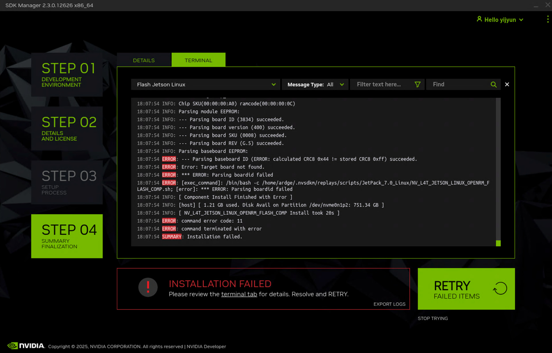

Failed to flash Thor by SDK Manager
I’m using SDK Manager to flash Thor, but an error occurred.
Below are the screenshots and logs.
My environment is Ubuntu 24.04.
But I can flash thor by jetson iso
SDKM_logs_JetPack_7.0_(rev._1)_Linux_for_Jetson_AGX_Thor_Developer_Kit_2025-11-05_18-07-03.zip (1.6 MB)
Some questions to confirm:
  • Do you modify the eeprom value?
  • Is thor a custom board or a developer kit?
  1. No.
  2. It should be a custom board. I am using a Jetson Thor from Advantech, MIC-743-AT
Please contact the vendor to obtain the customized BSP, as the SDK Manager typically only supports the development kit.
