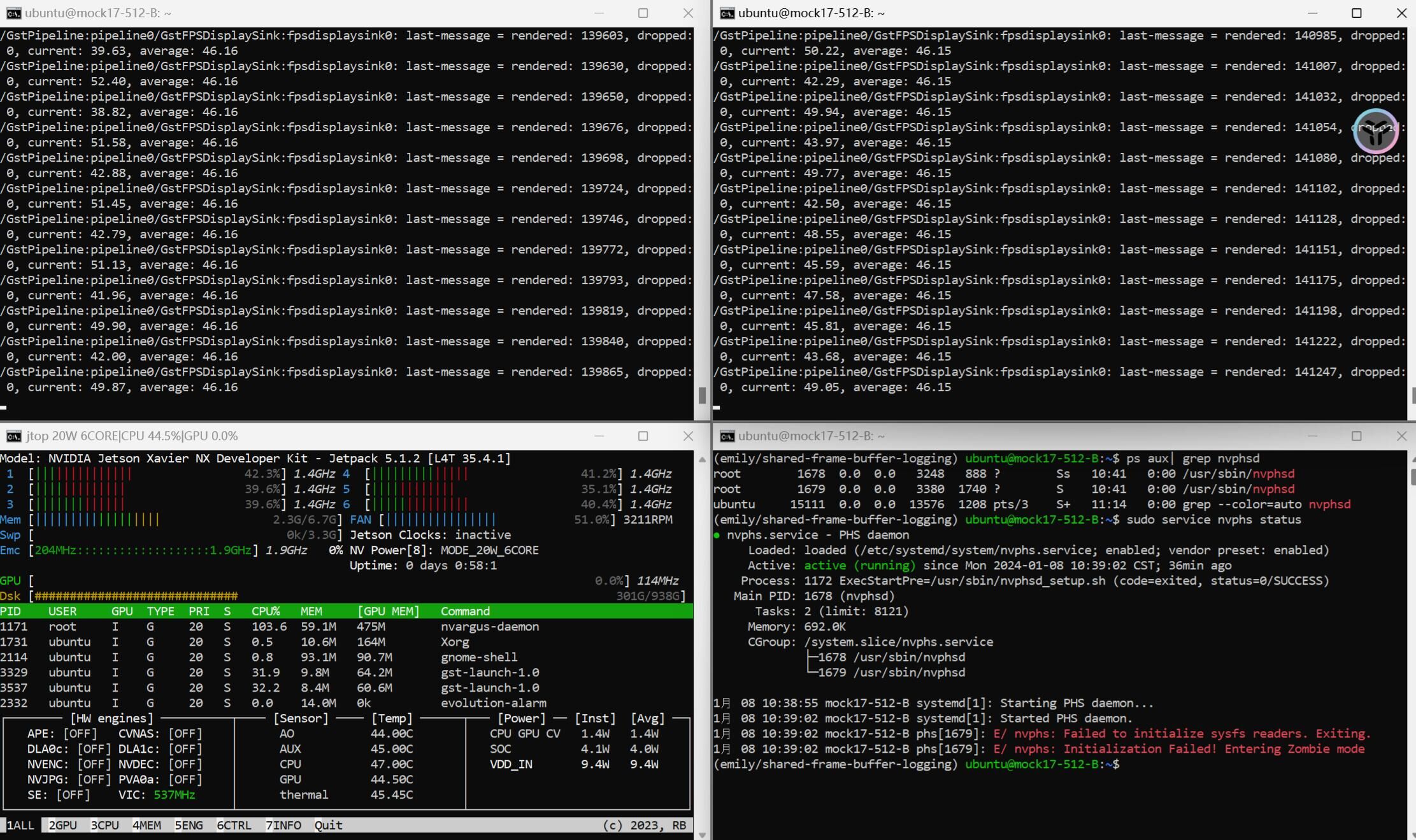

Below are the errors and tegrastats informantion, it doesn’t seem like it’s a temperature issue:
hello alexigu01x,

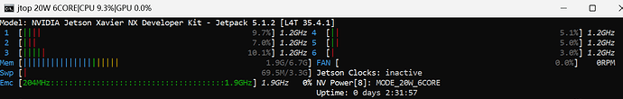

it seems all CPU resources has fully occupied.
may I know what’s the real use-case you’re worked with, and, how many camera streams you’ve enabled?
furthermore, according to Supported Modes and Power Efficiency, may I know which power-mode you’re using?

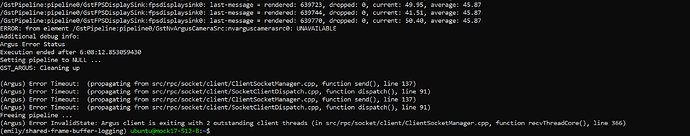

I ran two streams together and got errors from one of them ~
Here is the log:

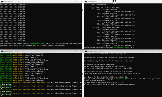

I used your command but there was no outputs in command line.
hello alexigu01x,
it’s reporting discarding frame messages, which meant it’s VI to drop the capture buffers due to errors.
please dump the sensor support formats, you should specify the same settings to the v4l pipeline.
$ v4l2-ctl -d /dev/video0 --list-formats-ext

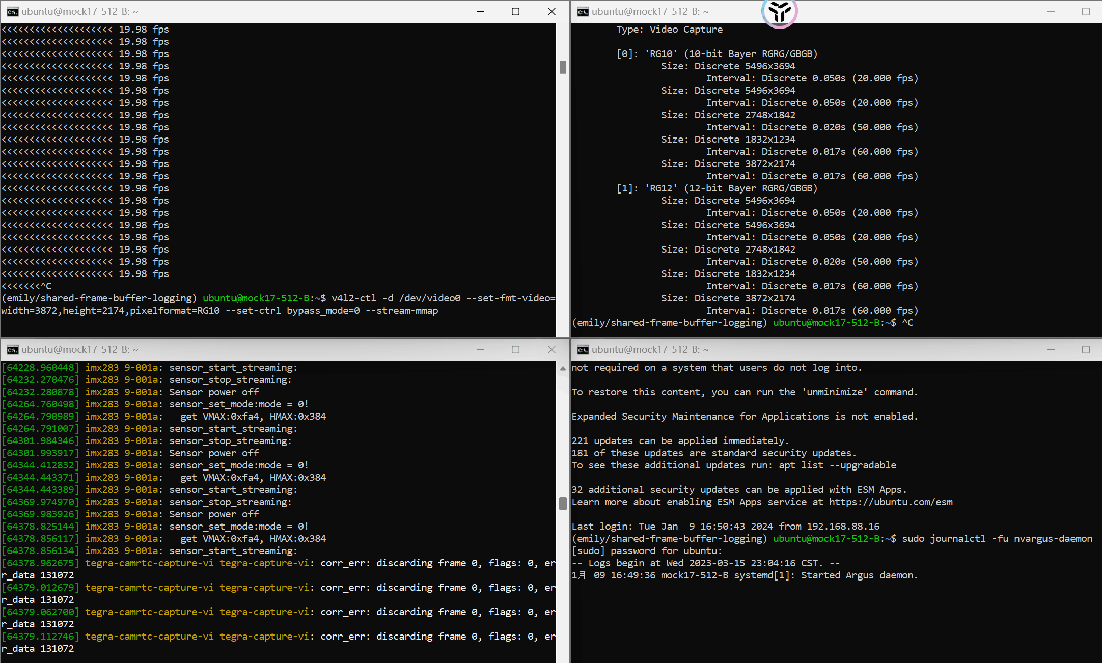

I changed the pixelformat to RG12 but all the width/height could only reach 19.98fps(e.g. the 3872*2174 supposed to have 60 fps but still 19.98 fps)
While my sensor supposed to support both RG10 and RG12 but when I used RG10, there was no outputs and had errors(I tried all the fps):
hello alexigu01x,
it’s likely driver side choosing 1st sensor mode (5496x3694@20-fps) for streaming.
to avoid this, you may add an optional Device Properties, use_sensor_mode_id to the device tree.
after that, you’ll able to enable mode selection, i.e. --set-ctrl sensor_mode=<N>
