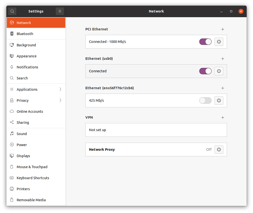

Frozen at Flashing 99%
Installing 99.80%
Hit continue after taking longer than expected
serial output below
[0005.345] I> Reset to recovery mode
