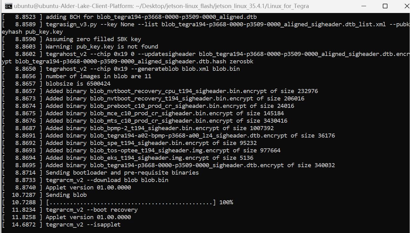

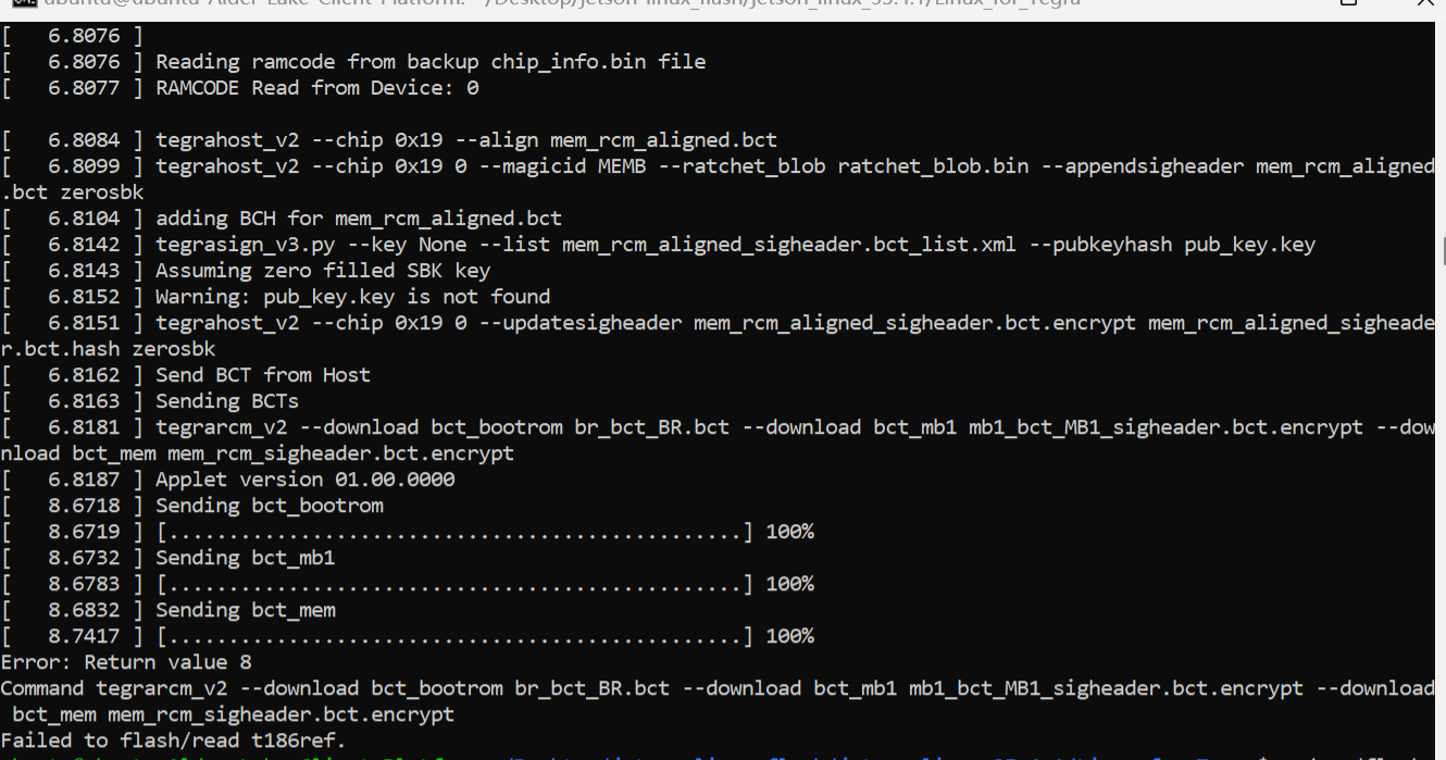

GMSL Camera fail on Orin Nano JatPack 5.1.2 - #5 by JerryChang We flashed the camera according to this topic’s guidance. We used the command: sudo ./flash.sh -r -k rce-fw jetson-agx-xavier-devkit mmcblk0p1 But got the errors:
Can you give me some instructions to solve it? I’d appreciate it.
Hi alexigu01x,
What Jetson platform are you using?
Are you using AGX-Xavier or Xavier-NX? please check and use correct config file.
Thank you for the reply. I wrote in the topic name, it’s xavier nx 8g ~ Should I use: sudo ./flash.sh -r -k rce-fw jetson-xavier-nx-devkit mmcblk0p1 to change the command I used? But after several attempts to use this command, it’s stuck here for hours:

We used a VM and based-on JP-5.1.2/l4t-r35.4.1 to flash the firmware of our devices. Only use this command :

it might be an issue with VM environment, you may review USB port forward settings.
or… please try with native Ubuntu OS.
I tried the command you listed above in a native Ubuntu OS and got the success message “The [rce-fw] has been updated successfully.”. I wonder if we need to flash ssd part after that or we only need to flash the emmc part to update the firmware?
