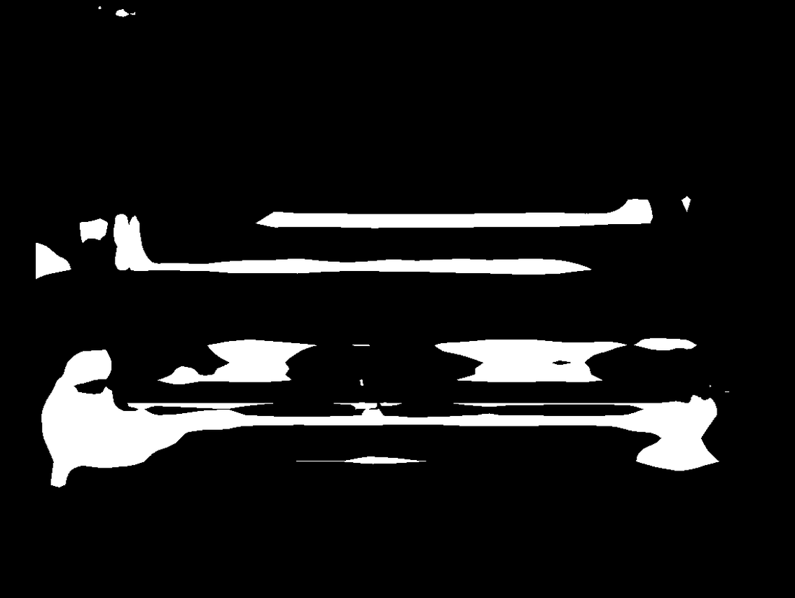

Edit: I further investigated the issue and found out that if I add another dimension to the neural network output I can obtain some buffer content but ONLY using the C demo as a base (Same error in Python). I saw that the old segmentation test app using UNET the output dimensions where Classes X Height X Width so I added a dimension to my neural network output which was only H x W before. If I read the NvDsInferSegmentationMeta struct for width, height and classes it all matches up but reading the buffer content directly the output is very different from my inference output using the tensorrt engine directly.

My output looks like this:
But the output without deepstream just using my tensorrt engine model:
Could you chekc nvdsinfer_context_impl_output_parsing.cpp->fillSegmentationOutput
Thank you for the reply.
I managed to read the correct segmentation mask output in the meanwhile but it only works using the DeepStream C API. Python still doesn’t work, probing the buffer for the NvDsInferSegmentationMeta struct still doesn’t return any output. I found some deepstream sample code for probing the buffer but there is nothing except a //Todo comment in the code.
Could it be possible that the Python API for NvDsInferSegmentationMeta is not implemented yet?
Hi blubthefish, the Python API for NvDsInferSegmentationMeta is indeed not implemented yet. It will be in a future release.
Thanks for the reply and clarification, I will be going with the C++ API then!
