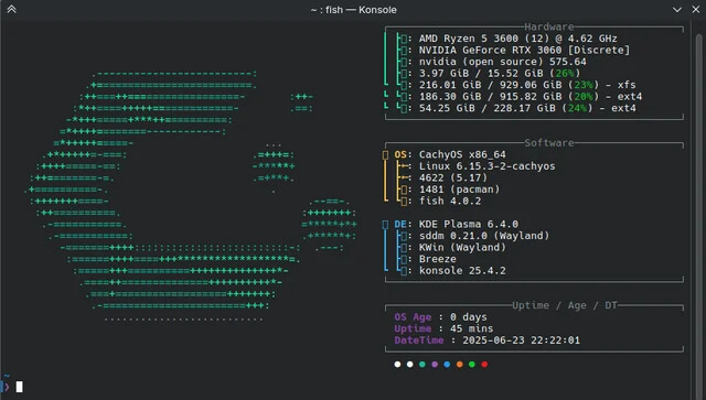

my system keeps freezing and the only way i can use my computer is by doind a hard reset, this has been hapening to me since i moved to using linux as my main os, happened on cachy os and nobara both with kde plasma, MANY reinstalls later and the issue presists.
the issue happens lots of time while im watching youtube, other times i was jus using my computer as usual, writing code, movig windows around and boom freez, i have no idea what trigggers it but im willing to try anything but switch back to windows 11, please if you can help me with any lead or link it would be much appreciated.
My hardware:

Hi @ItsYaSeen , please take a bug report after the issue occurs and attach it here. To take a bug report, you can run sudo nvidia-bug-report.sh in a terminal, and the nvidia-bug-report.log.gz file will be created in the current working directory.
