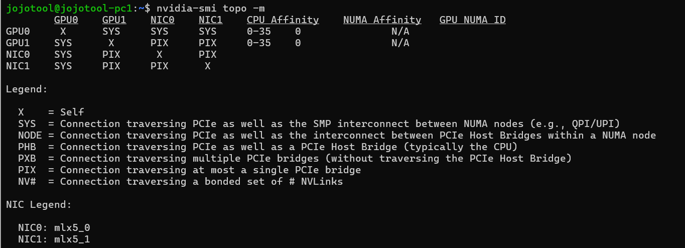

  4. Topology: nvidia-smi topo -m shows PIX, indicating both devices are under the same PCIe root complex/switch.

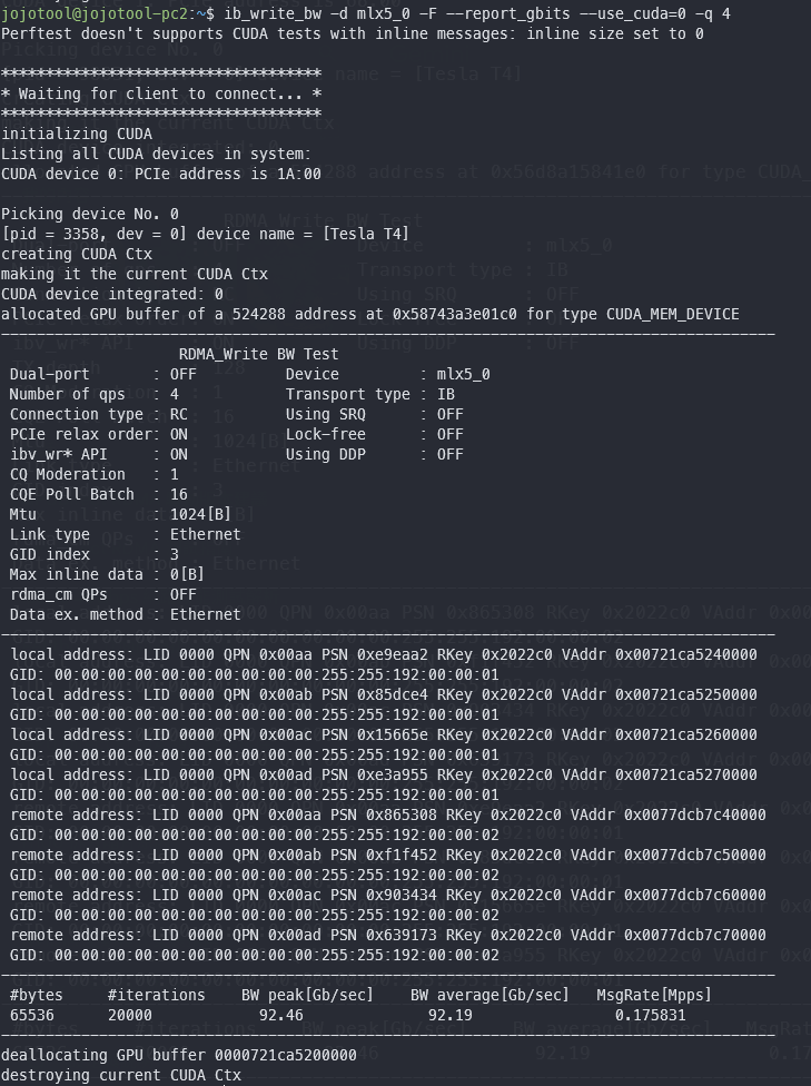

The Solution: I used setpci to manually disable the ACS bits on all PLX bridges. As soon as I did this, the “detour” to the CPU was removed.
The Result: After running the script, ib_write_bw instantly jumped from 38 Gbps to ~92.19 Gbps! (Screenshot attached)
