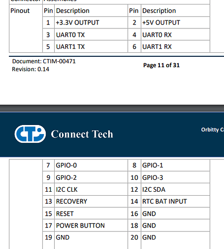

The orbitty carrier board has this pinout:
Also this is the reference table
Every time I have to run echo 388 > /sys/class/gpio/export so I can use the GPIO 388
So I have to grant permission every time.
Do you have an advice?
hello alberto18_90,
you may have kernel driver implementation to control GPIO-388 from low-level driver instead of sysnodes.

hello alberto18_90,
to grant permission, you’ll need to build your own kernel to toggle the pin.
