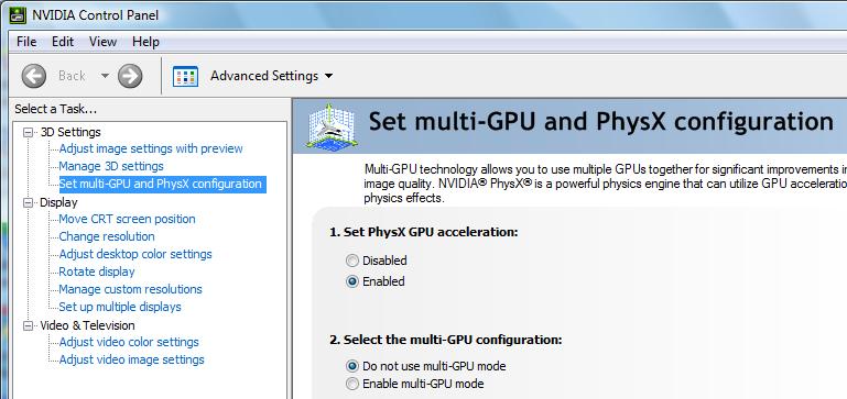

I’ve just faced exactly the same problem with GTX 295 being seen by Vista as one device. This can be solved by changing multi-gpu settings in NVIDIA Control Panel. Please check attached screenshot for settings which make Vista see GTX 295 as two devices.
Thanks, AndreiB. I tried the same thing but it did not work. It was not until I plugged in a second monitor and turned off SLI that I could get it to work correctly. But I did get it to work correctly.
