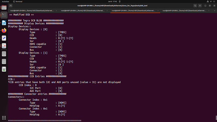

we want to work with HDMI on Jetson Agx Orin.
Can you please guide me to the changes required on Dts files so that i can workout HDMI.
DP port is working then need to work on HDMI on custom board.
i’m currently using release R36.4.3 .

please refer to p3509-a02-p3767-0000.conf
These 4 files are for Orin NX/Nano but you could do similar changes to Orin AGX files.
31 PINMUX_CONFIG="tegra234-mb1-bct-pinmux-p3767-hdmi-a03.dtsi";
32 PMC_CONFIG="tegra234-mb1-bct-padvoltage-p3767-hdmi-a03.dtsi";
33 OVERLAY_DTB_FILE+=",tegra234-dcb-p3767-0000-hdmi.dtbo";
34 DCE_OVERLAY_DTB_FILE="tegra234-dcb-p3767-0000-hdmi.dtbo";

1.In AGX orin there some .conf file like p3737-0000-p3701-0000.conf ect. in with file i need to changed.
2.To change pin configuration from DP to HDMI pinout are same i didn’t find any thing to change? let me correct if am wrong.
only PM0 need to configured,
Yes, you could put it in p3737-0000-p3701-0000.conf if that one is for your flash config.
You could diff tegra234-mb1-bct-pinmux-p3767-hdmi-a03.dtsi and tegra234-mb1-bct-pinmux-p3767-dp.dtsi and see if PM0 is only the difference. If so, then it is.

i am able to detect the hp monitor but i am unable get the display.
var_log_Xor.0.log.txt (23.8 KB)
Can you guide me to resolve the problem.

we are able to get the monitor details.but we are not able to get screen.
Instead of P13AUX221ZTAEX IC we are using FDV301N IC for HPD.
This FDV301N will cause any problem.
I don’t really care about hardware for now. I just want to know what did you do in your software to configure this.

Please try to give every detail but not just “changed DCB”. Where did you change DCB? Are you sure your “new DCB” really gets flashed to your board?
Did you ever make hotplug gpio in the device tree?
os_gpio_hotplug_a = <&tegra_main_gpio TEGRA234_MAIN_GPIO(M, 1) 0>;
Did you add that?
Sorry, one typo here. It should be M,0 but not M,1.
So you need to modify tegra234-mb1-bct-gpio-p3701-0000-a04.dtsi
Also, you still need OVERLAY_DTB_FILE and DCE_OVERLAY_DTB_FILE in your board config. You don’t need to modify any DCB thing there because these two fields will cover that.
Then just add it… look into the content of tegra234-dcb-p3767-0000-hdmi.dtbo and then make your own dtbo file…
