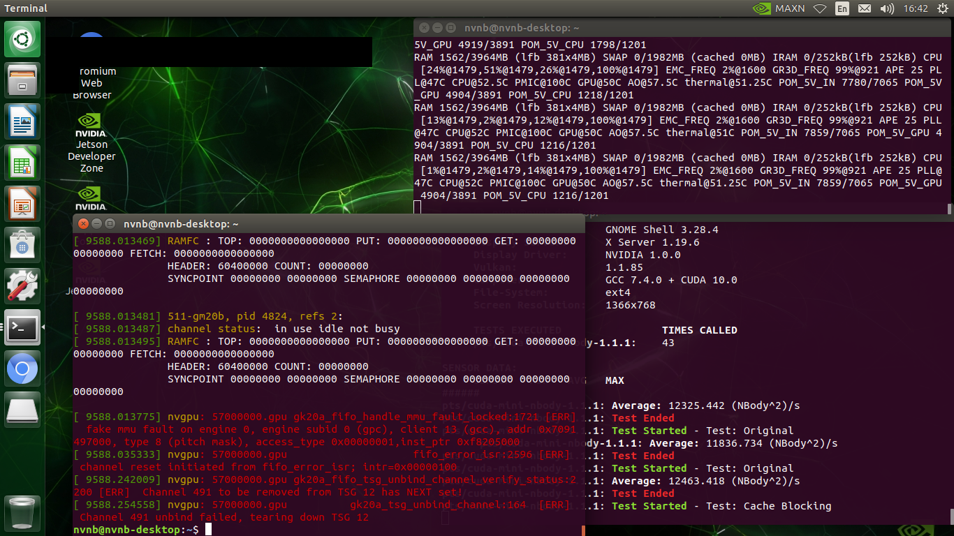

We use nano demo kit and running cude but find HDMI output was flicker.
our test setp:
1. install phoronix-test-suite_9.4
2. Open terminal and use “export TOTAL_LOOP_TIME=99999999999999999999”
3. Run “phoronix-test-suite stress-run pts/cuda-mini-nbody”
Bill

Hi bill_tu,
We can see the black line on your screenshot. But could you share the tegrastats as a file instead of a picture?
Please always share the log as text file instead of picture unless you cannot share it as text.

Hi WayneWWW,
I got the issue too.
I uploaded the tegrastats and log information I got In my case. (see attached)
The settings:
Nano B01 evb board
Jatpack 4.3(R32.3.1)
use sdkmanager
test two Nanos
Thank you,display_start_stats.log (87.4 KB) dispaly_error_3.log (128.4 KB)
Hi HuiW,
Thanks for sharing the log. We are trying to reproduce this issue again.
According to the video file in your mail, I notice you are using the terminal on screen but our test was on remote access with ssh. The tegrastats lines showing up on your screen is causing more gpu rendering in your case than ours. I guess that is the reason we didn’t reproduce error.
To make this bug more clear, it is a rendering issue when gpu is under stress test (99%).
Hi HuiW,
This error log indicates the problem is from userspace tool but not nvgpu driver. Could you try other tool to run the gpu stress?
  [ 9378.548115] nvgpu: 57000000.gpu gk20a_fifo_tsg_unbind_channel_verify_status:2200 [ERR]  Channel 491 to be removed from TSG 12 has NEXT set!
