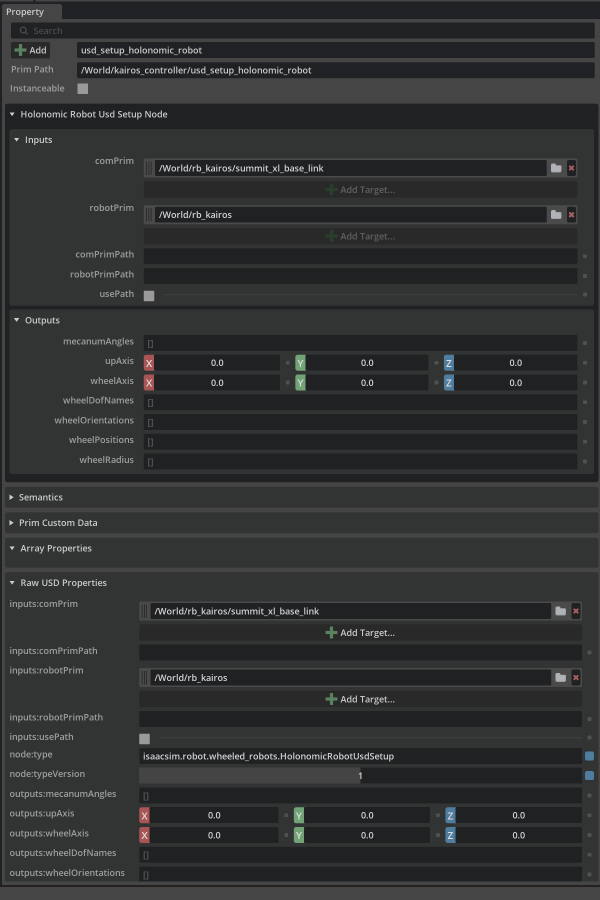

However, I am getting a new error. I am trying to setup my 4 omni wheel robot urdf in Isaac Sim. I have also created the action graph using the “USD Setup Holonomic Robot” and “Holonomic controller” which I already tested for Kaya robot and it works.
But the “USD Setup Holonomic Robot” node gives me an error as
“Omnigraph error: local variable “joint” referenced before assignment”

If you are using your urdf file as it is, it is unlikely you have all the terms needed for the “Usd Setup holonomic” node to work. I see you also posted on a different thread about this robot. Did you follow the steps mentioned earlier in that thread about saving your robot into a .usda file first and search for terms like “mecanum” to check if you have all the necessarily paramters first?
Your .usd (or .usda) file need to have all of the following terms in order for the “usd setup holonomic” node to work: the wheel radius, positions and orientations (relative to center of mass of the vehicle), the mecanum angles of each wheel, and the axis of the wheels relative the chassis axis.
if you are missing any of the fields, you can manually modify the .usda file to include them (for this you can use kaya as a reference file). You can also not use the USd setup holonomic node, and just put in all the numbers you need for the holonomic controller directly.

The extra term you are adding into the usda file is a specialized USD schema that we added to aid calculating holonomic drives, it’s not something URDF has as far as I’m aware.
To avoid editing usda file repeatedly, you can certainly save the edited usda file as it is and open that in the future if it’s just a single robot. If you are starting with a URDF file every single time, then I would suggest you add more nodes to your graph to supplement the setup node. You can manually feed in the missing information into the “holonomic controller”. For example, if you don’t have the “mecanum angles” field in your usd file, you can add an array node, manually put in the array of angles, and feed that into the “holonomic controller”. You should still be able to use the setup node to get other parameters.
The bottom line is that the “holonomic controller” node is the one that’s doing all the vehicle speed → wheel speed calculation. The setup node is just reading parameters, so if it has trouble finding the parameters, you can always manually put it in.

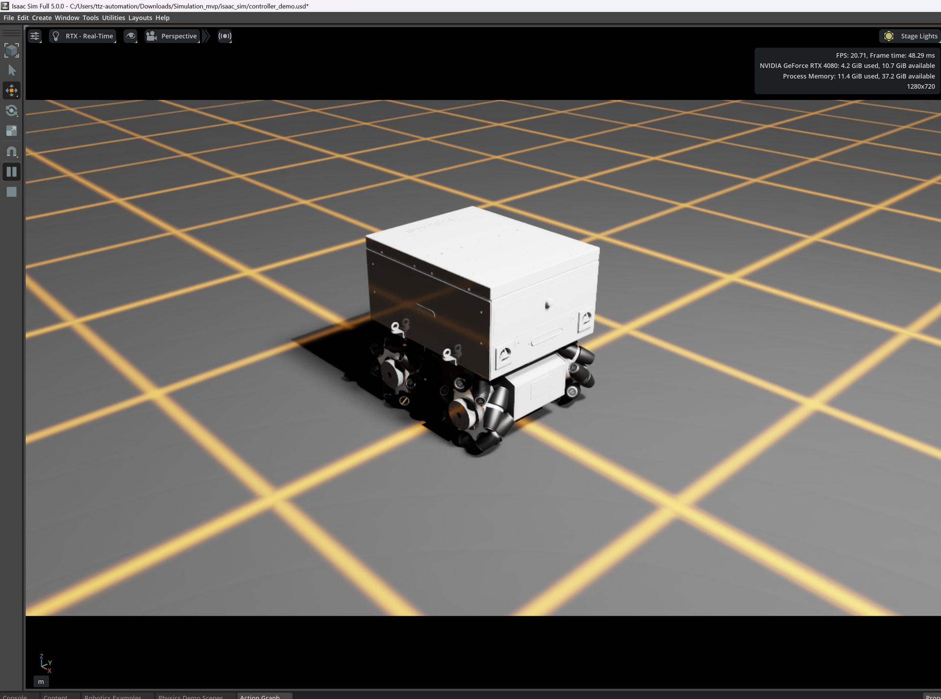

Hi @nilutpolkashyap I cannot help you to solve your problem, because I am new to the Isaac sim. However, would you mind to give me the 4 omni wheel robot model ? I want to simulate this kind of robot but I cannot find any good model on the internet.
Warm regards !
Continuing the discussion from HolonomicController node in action graph for 4 omni-directional wheel robot:
I am studing your work for action graph. I am seeing that you have not considered linear y, if possible can you share your updated action graph plz.
Also I am bit confused in the usd setup holonomic controller node, so if possible this one too.
Also, can we directly create constants replacing ‘usd setup holonomic robot’???
