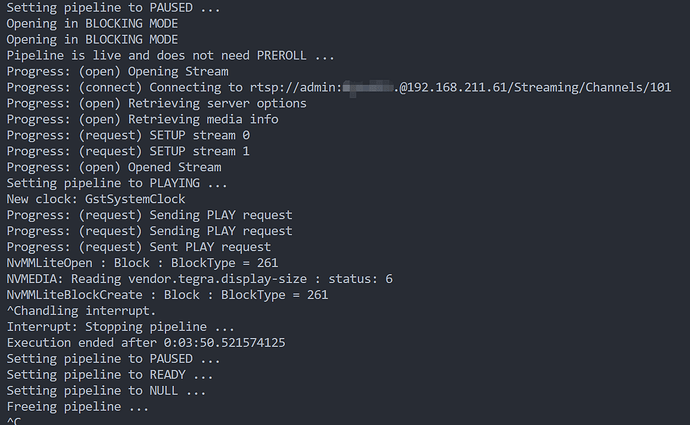

I have tried many ways, such as
gst-launch-1.0 rtspsrc location="rtsp://admin:xxxxxx.@192.168.211.61/Streaming/Channels/101" latency=200 ! queue ! rtph264depay ! nvv4l2decoder ! queue ! filesink location=a.mkv
result like this
or jetson-utils
video-viewer rtsp://admin:xxxxxx.@192.168.211.61/Streaming/Channels/101 a.mp4
It seems that none of these methods can decode rtsp streams.
Jetpack 4.5.1 [L4T 32.5.1]
GStreamer 1.14.5

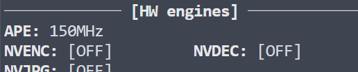

Please try with fakesink:
$ gst-launch-1.0 rtspsrc location="rtsp://admin:xxxxxx.@192.168.211.61/Streaming/Channels/101" latency=200 ! queue ! rtph264depay ! nvv4l2decoder ! fakesink sync=0
And run sudo tegrastats to check if NVDEC is on.
I recommend using a parser after the depay and nvvidconv after the decoder:
gst-launch-1.0 rtspsrc \
location="rtsp://admin:xxxxxx.@192.168.211.61/Streaming/Channels/101" latency=200 ! \
queue ! rtph264depay ! h264parse ! nvv4l2decoder ! queue ! nvvidconv ! filesink location=a.mkv
