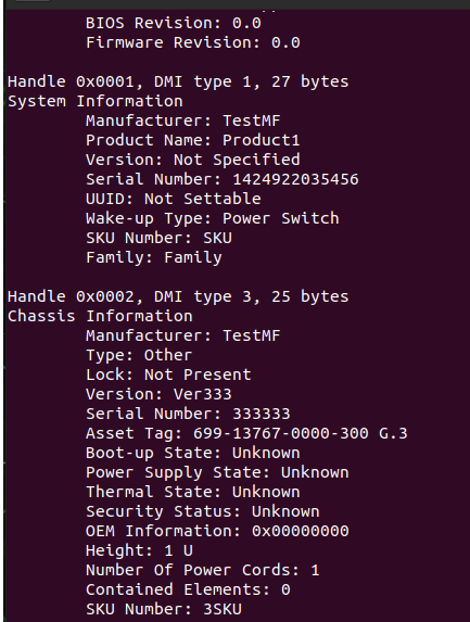

I follow nvidia uefi wiki document to modify smbios type 1/2/3.
https://github.com/NVIDIA/edk2-nvidia/wiki/Smbios
I can set the smbios value and get them by dmidecode.
How can I set smbios in Orin NX Ubuntu system?
Does nvidia have any tool to set dmi information?
We want to set the serial number of product in mass production.
But we can’t modify uefi release file for every device.
Please help us.

Hi Kevin,
I’m using our custom board.
I know the EEPROM has the SN of Orin NX module.
But we product the all system include custom board, chassis, and system image.
We want to add our SN for the full system product.
It’s convenience for us to mantain and record the system product.
Have you tried to add custom information in EEPROM of “Customer-overwritable section.”?
Hi Kevin,
I can set the value of EEPROM byte 221-235.
But how can I let the SMBIOS SN read the byte 221-235?
Please check how SMBIOS read byte 74–88.

In x86, the SMBIOS info is saved in the nvram.
And we can change the SMBIOS info in the Ubuntu OS system in anytime by some tools of the BIOS vender.
In the Orin NX, where is the SMBIOS saved? Is it just only modify by uefi source code?
Or we can change the settings or info by some tools in the Ubuntu system by anytime?
SMBIOS tables are created from info from chip and platform.
UEFI generates info at boot time and passes that to OS.
Hi Kevin,
So We can’t modify the SMBIOS by the Ubuntu command line or tools?

Hi Kevin,
We want to set the type 1/2/3 at least.
Because we want to sell the system to the custmer.
They can set the smbios of their company and sell the system to the end user.
In x86, we can do this way easily.
Can you dump dmidecode from OS and share with us?

Handle 0x0001, DMI type 1, 27 bytes
System Information
	Manufacturer: TestMF
	Product Name: Product1
	Version: Not Specified
	Serial Number: 1234567890abc
	UUID: Not Settable
	Wake-up Type: Power Switch
	SKU Number: SKU
	Family: Family
Handle 0x0002, DMI type 3, 25 bytes
Chassis Information
	Type: Other
	Lock: Not Present
	Version: Ver333
	Serial Number: 333333
	Asset Tag: 699-13767-0000-300 G.3
