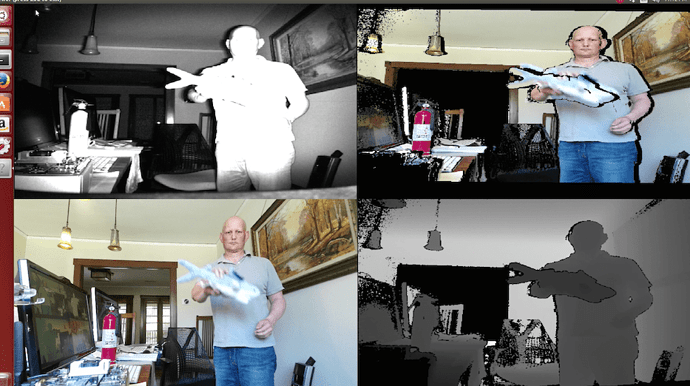

This does not answer your question, but may help if all you are trying to do is get the Kinect V2 work with the TX1.
The Kinect V2 will run off the Jetson TX1 USB port with a patch recently supplied by NVIDIA. See:

Were you able to get the Kinect V2 working with the Protonect example on libfreenect2?
I was able to get the Kinect V2 connected to onboard USB3.0 working with the Protonect example on your patched libfreenect2.

Now I was able to get the Kinect V2 connected to PCI-E USB3.0 supplied the power of the desktop computer working with the Protonect example OpenPTrack libfreenect2.
