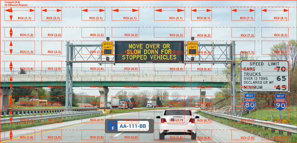

  • Multiple Regions: The sensor’s ROI function enables the cropping and reading signals from multiple arbitrary positions. Users can define up to 64 areas for cropping, with these areas determined by selecting up to 8 horizontal and 8 vertical points as shown below.
  • Flexible Cropping: Selection uses the pixel start position as the origin (0, 0) in all pixel scan mode, allowing for a high degree of customization in selecting the areas of interest.
  • For the ROI mode, the horizontal period (Hmax) is fixed. This means that all cropped areas will have a consistent horizontal dimension, simplifying the configuration and ensuring uniformity across different ROI settings.
  • The areas cropped based on the horizontal cropping settings (from ROI (1, y) to ROI (8, y)) are output with left justification, thus extending the horizontal blanking period.
  • In the case of vertical cropping (from ROI (x, 1) to ROI (x, 8)), the output includes the number of image data lines starting from the cropping start line. The frame rate can be finely adjusted by altering the number of input XVS lines in slave mode or changing the register VMAX in master mode. This flexibility allows users to optimize the frame rate based on the application needs.
