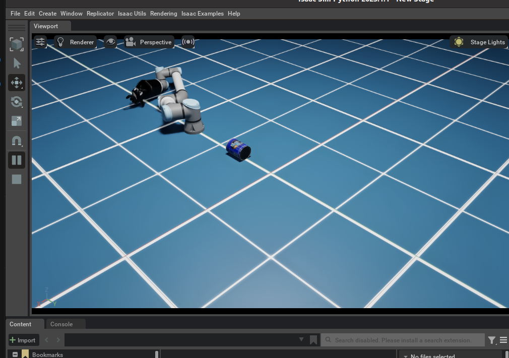

How to achieve precise position control?
As shown in figure, I want to excute the Grasp task. At some point, I’ll give you the action (joint_position) that the current robot should take. But when I apply_action, I printed out the position of the robot’s joints after taking the action.
For example, the apply_action is {‘joint_positions’: [0.8238084055528784, 3.258773222356317, -5.2842312866369926e-08, 4.434514459746221, -1.0435168082945858, -3.1561408382919662, -0.462833, 0.026872018, -0.21439794, -0.5247767, 0.006703197, -0.5795436, -0.10016193, -0.44172207, -0.6632077, -0.15272766, -0.12983315, 0.9999972, -0.6881444, -0.48795903, 0.07503456, 0.24684206, -0.31400064, 0.10682098, -0.26788008, -0.20708056, -0.10136456, 0.9999972, -0.17098865, -0.49769205], ‘joint_velocities’: None, ‘joint_efforts’: None}.
Is the stiffness of joint set? It should be set to a high enough value to hold position.
I don’t think this will solve my problem. I took a look at the stiffness I set, and it was big enough. Is there a better solution?
This is the code for the robot to excute the action. I use the lula kinematics solver to obtain the arm joint position. And I set up an extra hand joint.
It’s worth noting that I took my robot to execute franka_follow_ik.py and used the Lula Kinematics Solver. After execution, the arm’s joint position is correct. I don’t know why it doesn’t work when I add hand joint position. Another difference from franka_follow_ik.py is that I give Lula Kinematics Solver a target position at every moment. I initially thought that the target position was sent too often, so I set up a loop to execute the apply_action more so that the robot had a cached time. But it don’t work.
I would like to know how to solve this problem (Given the position of the robot joints at each moment so that it can reach quickly).

If you want to get a critical answer, you should at least the full script and USD to reproduce the scene.

Hi @1878720579 - Developers are working on solution (will be available in upcoming release) that would help solve the issue.
Meanwhile, can you share you USD file, so I can redirect it to right dev to help you further.
